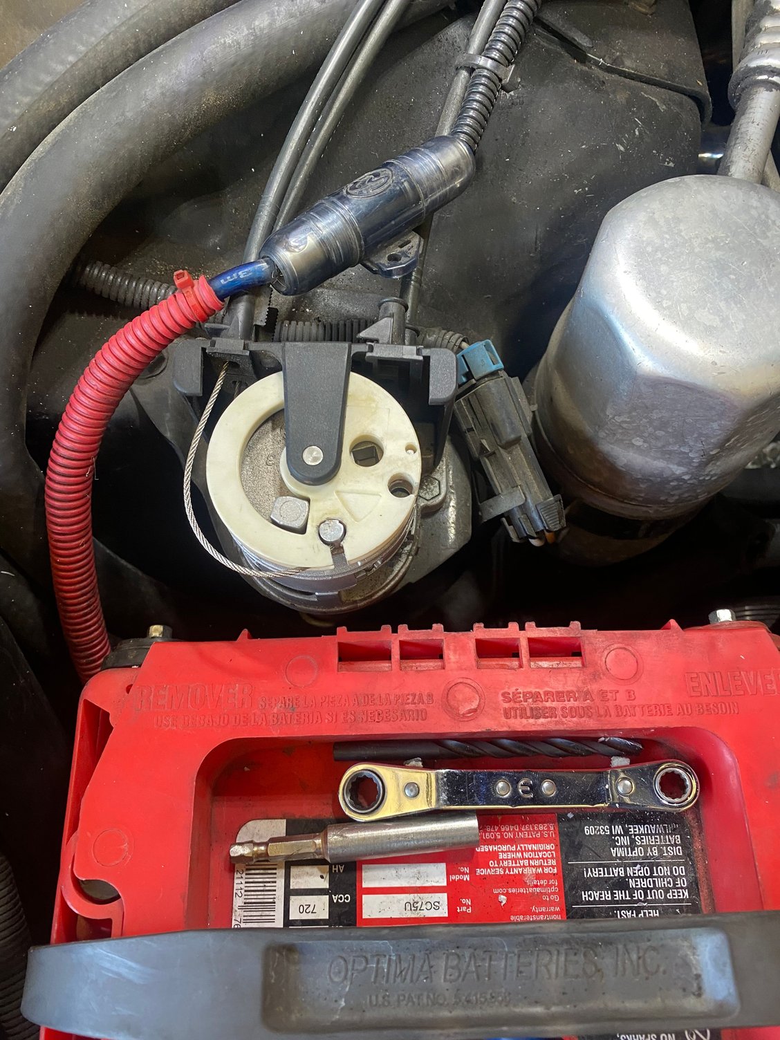

So installed a nitrous plate and now the throttle body sticks open a little bit and won’t go down. How do you adjust the cruise/throttle piece so it’ll go back down? I already released the black box by the manifold all the way and just need a half an inch
