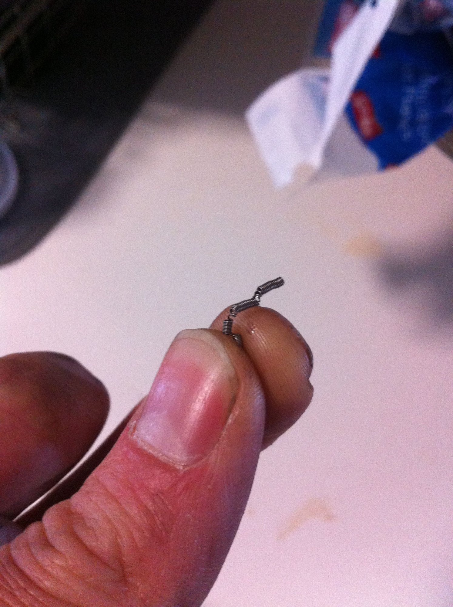

I popped off the drain plug to change the oil and noticed this little dude stuck to the magnet? What is it?

almost looks like a piece of spring from a rear or front crankshaft seal.
or from a valve seal. hard to judge the size.

That spring is from a valve seal.
The front & rear crank seals do not have springs.

Knew it was valve seal before I clicked the tread

yep, you nailed it. I had a couple old seals laying around and thats exactly what it looks like. is this a common thing? I obviously need to get these replaced ASAP
btw its a 2000 WS6 Automatic 120xxx miles

No worries. Not really a common thing but it happens.

It's common enough, remove valve covers and have to remove the springs. Perfect time for cam and valve spring upgrade!
