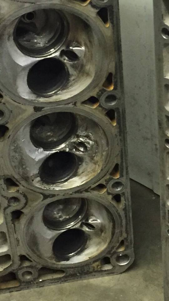

243 still salvageable?

I have seen some pretty bad heads repaired, best to get advice from a head shop like Tony Mamo, AI, etc. Of course there may not be a good cost trade-off between repair and replacement if this is a stock 243 head.
Looks like a stock head to me from the shape of the runners. At that point you might as well replace it.
This! They aren't going to be worth it. Those will need to be milled, chambers repaired, some of the seats look beat and I am guessing you have or will be buying new valves, you will want to have those lapped as well. Just guessing the above will roughly run you atleast 300-400 bucks at the machine shop. You could find nice take-offs with valves for that.
