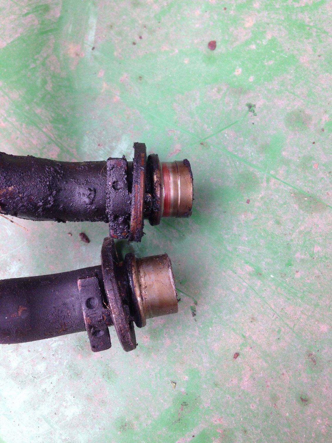

So after looking at both old pickup tubes between the 2 engines. One had an orange seal (newest engine still in car) and the other had a gray seal.... I see the orange style has an indentation.... Is there a difference between the 2 or are all seals interchangeable. I believe the ls1 pan was smooth like the first engine. I used an orange type seal on the current setup

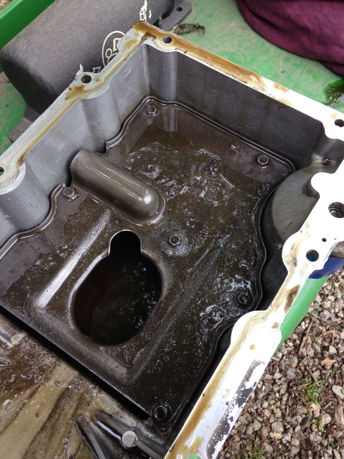

So I got some measurements with a level of the pan depth from where it mounts to the block and from the bottom only the pickup tube to the gasket where the pan mounts to. I got 5.25 pan depth and 4.85 from pickup screen bottom to gasket where pan seats on so that's .4 which is just barely outside of 3/8 and I had a tad extra oil in the pan this time so I'm guessing that clearance is definitely not the issue..... I really just dunno what the hell I'm missing here. I also have just pulled the pickup tube out and the O ring fits snug and is not torn or pinched at all. This engine is definitely hosed because there is a surplus of metal on the pan..... What can take bearings out so quick? Is it the used ls6 cam? I can't see the intake or crank dampner causing this. And those are the only common parts in the swap. Windage tray is an ls1 and installed correctly

post up some pics of everything, maybe it will help. From the looks of those pickup tubes the engine was well worn.

I will get some pictures posted tomorrow... And yes this last engine was much more worn than the first from the caking on everything and looking at the cylinder walls. I suppose it's possible if everything else was that worn then the oil pump itself might not have been too happy. The 2 pictures I do have are of the devastation that just occurred in there and the cam that I put in which was way cleaner than the one I pulled out.
