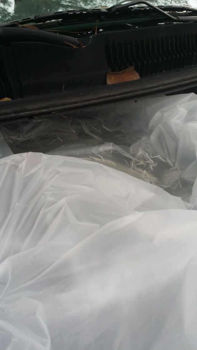

When my car is sitting, I always put a plastic bag over the engine. This is what got in your engine. My car sat for exactly a week with two days being 100% rain those two days. If you haven't had time to seal up the cowl like me, put a plastic bag over the cowl and raise up the hood and put a plastic bag over your engine. Looks ghetto, but atleast you know your engine wont go to **** when you crank it up.
