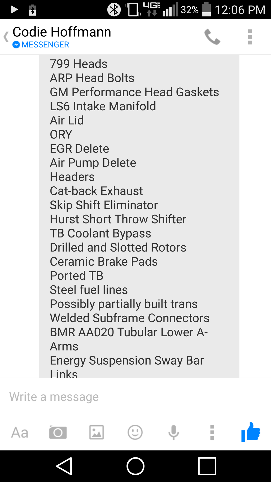

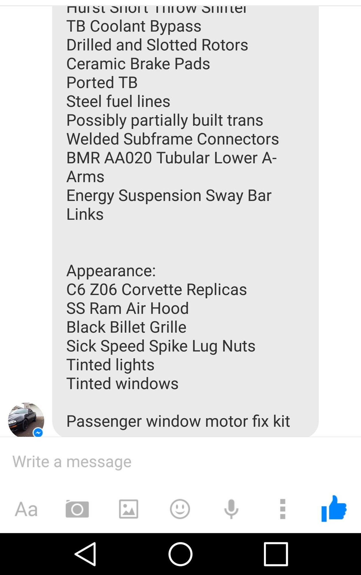

I recently bought a 2000 z28 m6. It has a mild build but i wamt a bit more out of it. I definitely want to put a cam in it and the rest is undecided. The only things i know forsure that are done to it is heads, air lid, intake, long tubes, ory, catback, tubual lower control arms, sub frame connectors and short throw shifter. The rest the guy i bought it from said they previous owner did. I would like to get the car around 450-500hp but it has to retain drivability because its a sunday cruising car amd will be driven a couple hundred miles. Id like to stay under 3k but may spend more. I attached pics of the mod list.

Without going up in cubes only think left to do is port the heads, fast 92/102 and a cam.... don't go crazy on the cam if you want to retain the same drivability.... Brian @ Briantooleyracing or martin @ tick performance would be the top choices for cam input

If you want good drive ability with that kind of power, you should call tony mamo. He's got some stuff on here hitting those kinds of numbers with moderate cams and phenomenal heads. You'll pay for them, but that's because they're worth it.
He can match up a cam and heads for you that'll give you what you are looking for.
Martin and Brian are excellent cam gods, so not taking anything away, but on a set of 799's you'll be pushing it.

799 are very good factory heads. Same as the 243 heads. To get into the 450-500 range at the wheels - especially with good drive ability- they would need significant porting.
If you're willing to sacrifice driveability, get a much bigger cam and call it a day.
If you want it to drive more stock-ish with that kind of power, spend the money for really good aftermarket heads
