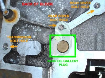

What about the rear oil gallery plug?

I never did try the huge green one. I installed blue with both oil pumps. Then I tried a thicker red one with the stock oil pump. Which was a very tight fit. I did try a 20-50 oil for about 20 miles. Oil pressure would ride around 18 hot. I felt it was masking the issue and not solving it. Rear galley plug is installed I assumed this was the problem and pulled the motor the first time
