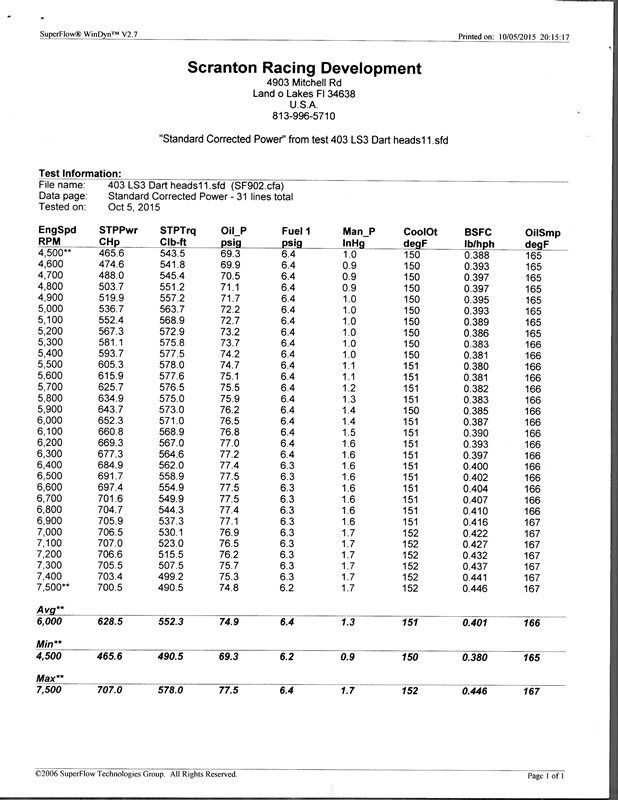

Now the Dart Pro1 LS3 headed 403" LS2
Originally Posted by speedtigger
403"
4.005" LS2 Block
Callies Compstar 4"crank and 6.125" Compstar rods
Bullet CP 11.5:1 compression flat top pistons
Dart Pro1 LS3 heads milled to 65 cc.
FelPro 1161-.041 MLS gaskets
247/259 110.5+3.5 .660"/.650" Cam Motion Low Lash Roller
Edelbrock Victor Jr. intake
835 CFM 4150 Holley
1 7/8" ARH headers
Melling 10295 pump and a Mast Oil Pan.
707 Horsepower @ 7100 RPM & 578 Foot Pounds of torque at 5500 RPM.
So there you have it. Two very similar builds done by highly capable builders with similar compression, cams, intakes, headers etc. The smaller 403" engine, with a smaller 4.005" bore made more torque and horsepower than the 418" engine with a 4.070" bore. The difference? Cylinder heads. The Pro1 LS3 heads made 10 more ft lbs of torque at the same RPM than the cathedral port heads and 30 more horsepower at 200 RPM higher. Also, the cathedral port engine used a vacuum pump which boost power while the square port engine did not.
Disclaimer: These tests were done on two different dynos at different times with all the variable that can imply.
