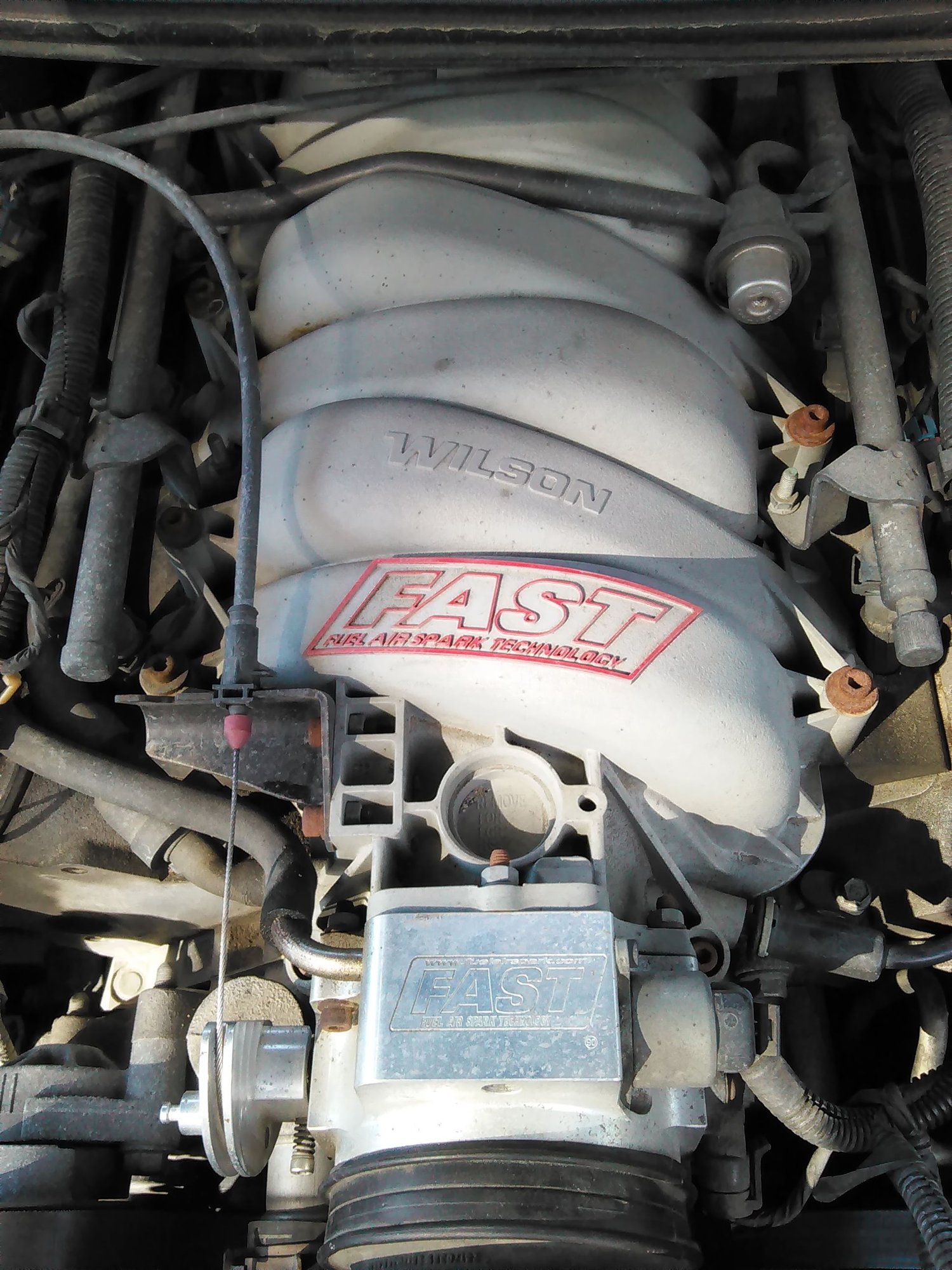

Here's a pic of the fast Tb and fast intake.

Whatever you do make sure you take that FAST intake apart. I lost my previous engine when I bought a used FAST 90mm from the classifieds. The previous owner grenade his engine and neglected to tell me. As soon as the intake got to operating temp it sucked a bunch of aluminum into the engine. Learn from my $2k mistake.
