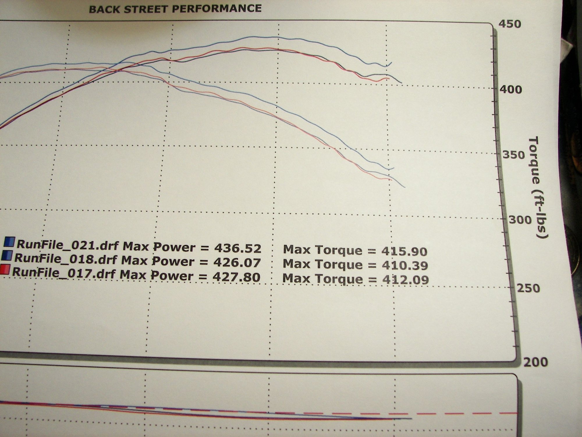

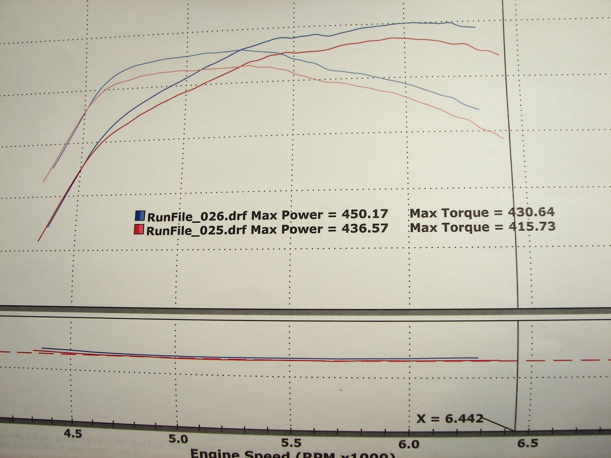

Now you have me wondering about my motor. I finally got everything sorted out with my 408 and up on the dyno and around 6500 the graph gets a bit weird. Tuner said it is possible valve float, so we kept the limiter at 6250. It doesn't make power up there like I was planning / hoping, apparently my calculations were off. I am running the series 5 Manton 11/32 rods with .120 walls. I will post up the graph.
Or I chose the wrong springs for my 242/254 629/603 - 114 (EPS specd, I was looking for high quality, and something that wasn't brutal on the valvetrain)

I am also running the 10mm Yellas and I am very happy with them, I had a different version of Harlands and there is no comparison. The quality on these is awesome. Just the trunions / bearing differences, The Yella's are beefy in that respect, I am confident in spinning my car up high with them (if I ever made power up there and needed to do so.)
first pic shows the anomaly, second was the final result. Yes I know my intake is not the best, and I am not running more adequate heads, leaving a lot of power out there (PRC 2.5 LS6. semi-ported Fast 92) I am no professional, but I took a long time researching and trying to make good decisions for it while also using parts that I had.

What springs? You need a little more on the seat and open with the YT. 160/450 or so and the cam might want even more on the seat depending on the lobes.
Also, what lifters?

Geoff has a nice selection of lobes and knows what he is doing, so I don't feel it's the camshaft. That said I would like to plot the events just for my own knowledge, do you know what ICL it's ground on?
I have used the PRC .675" springs on a few other roller rocker combinations. I've always shimmed them to give 170-180 on the seat. With most of the lobes I run with those springs and roller rockers, open would end up around 465-475.
I don't think spring pressure is really an issue with your combo, and unless your preload is way out in left field I don't think it's the lifters either.
Although I prefer a dual tapered 5/16" to 3/8" which is a bit stiffer than the 11/32", the 11/32" should be sufficient to keep deflection at bay. At least to an extent to allow for a smooth power curve that carries well.
IMO I think your motor just doesn't have enough cylinder head on it to make much more power.

Those are the 5206s... should be fine with those pressures and RPM.
Is that a 346? That's a big cam in a 346... and a very early peak for a 242 intake lobe on a 114 (assuming 110 ICL). Did you degree it?
What preload?

ICL is 111. I am almost positive that the springs are shimmed to the 1.800", I measured long ago. This is in a 408.
I don't believe Geoff did anything wrong at all, I am just trying to figure out why the graph suddenly changed around 6500, never seen that before and when I first read this thread, lofting that you mentioned got me thinking.
I talked with Lunati and they said that preload should be around .030-.060. Some have pushed these to .090. I measured every one multiple times and wrote the measurements down. These pushrods were purchased when I had a different rocker setup. After they went bad, I talked with Tony and he recommended the 10mm versions. Luckily these pushrods kept me in the .030-.060 range so I used them. I also measured every pushrod and matched them up to each lifter to make sure it was all in spec. I was very surprised to find that the range in measurements of pushrods from the original 7.400 spec that I ordered was up to .020 different from largest to smallest, but after matching them up with each lifter, I stayed in the recommended range.
I know the heads are too small, things may change in the future, many ideas in my head and not sure what to go with.

I degreed the cam 4 or 5 times, matched up perfectly with the cam sheet.
I was concerned about going with a larger diameter pushrod since these are stock castings. When I pulled the heads and drilled / tapped them for the 10mm bolts, I also opened the pushrod holes to I think 9/16, I have pics somewhere of original -vs- new size, anyways, tons of room now. Only thing was that I didn't machine the pushrod holes down at the bottom of the head because I was unsure how much I could go before I would break through to a runner, so only the top is opened up.
