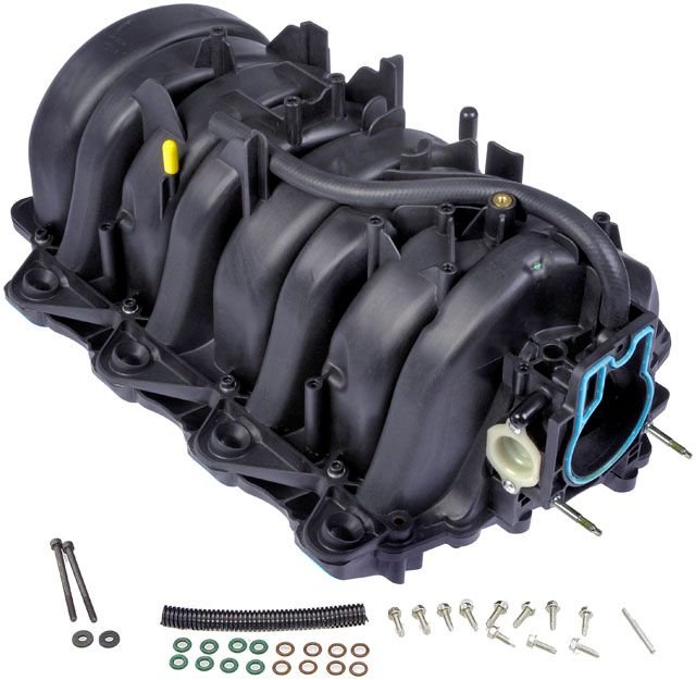

So the engine is at the machine shop now and in the mean time I have ben looking at intake manifolds, and the only thing that I am certain of is that I don't want a Fast intake, they cost way too much.
That said, I am having trouble finding intakes that have long runners, or am I just googleing it wrong? I want to keep it under the hood as well so no Holley hi-ram either.
Found this Dorman intake that got me a little interested, and it seems to have "long runners" correct me if i'm wrong but I think it's the truck or Trailblazer intake.
Anybody tried it?

That intake has been popping up a lot lately.
Zero solid data, other than it doesn't work well with boost.
I'm also not sure how long the runners are compared to a stock truck intake. It seems to have put the plenum underneath the runners instead of on top. The actual runner length might not be much different, but until someone checks, we won't know for sure.
