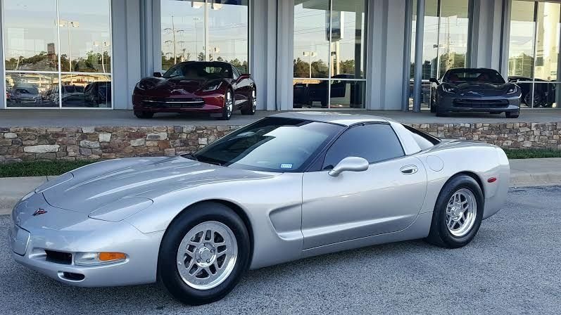

You would need to mill the heads around .015" - .020" to acheive the 11.0:1. Just make sure you maintain the stock valve sizing which will help with shrouding on the small bore.
I built my T/A with the BTR stage 3 and TFS 205 heads, they were at 58cc which commanded 11.5:1 with the stock LS6 intake and TB thee car made 440/410. It felt sluggish through the entire rpm range, swapped to a fast 92 and it woke up. The drivability improved 100%, only bucking was around 1100 - 1200 rpm. Keep in mind this was a 6 speed with 3:42's
The car made 454/421 earlier this week with a SD tune on a different dyno across the country in AZ.
I began building an A6 C6 LS2 corvette about 3 months ago, The car has 1 3/4 headers, Fast 102, and a Yank ss3600. This car made 400/400 on the same dyno as the T/A when it made 440. Pulling my hair out now trying to get the tranny shifting to my liking.
Best of luck

As intake duration increases, the intake closing point occurs much later. The engine cannot begin to compress the intake charge until the intake valve is closed. This equates to less timing requirements which help with low speed/throttle cruising.
My suggestion is to step back to a stage 2 camshaft in the 220's I / 230's E, which will allow for stockish compression and alleviate the PTV clearance concerns.
The combination will make around 10 less peak HP but the overall driveability will be better.
For example the corvette pictured above has a small 223/231 with stock 243's for the moment and has been a best of 6.98 @ 97mph, drivability is fantastic
