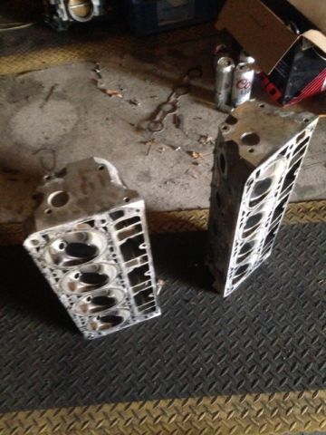

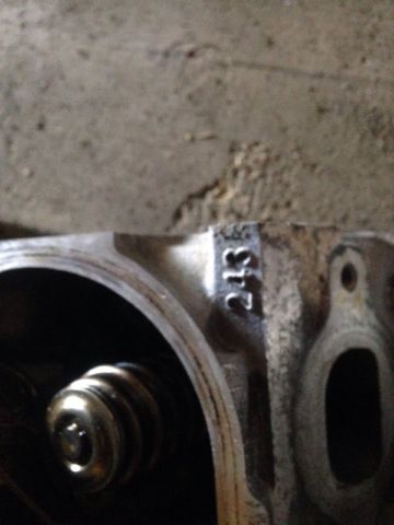

Thanks guys. So from what I understand these heads are strong realiable and can be fixed if anything. If worst came to worst would machining help fix any uneven surfaces warps etc?
Saying that. The set comes assembled and I know everyone says all 243 heads are the same which isn't the case is it guys ? (Z06 head).
Regarding valves I would probably get new valves and Springs etc to avoid any mishaps. + might as well build it since I have it out already.
These heads are off a 2010 4.8 Chevrolet truck is it still the same specs ?
These are the ones I'm ininterested in.

From what I recall all 243 heads are the same specs and the only difference with true zo6 243 heads were the lighter valves and I think they had blue or yellow valve springs.
Im also selling my set of 243 heads locally that are low mileage with some goodies.If the price is right and the heads look good then grab them and give them a good clean before you put them on.id also recommend new valve seals.

yep. 243 is a 243 unless z06 or ls2 and then it is valves/springs and springs respectively.
