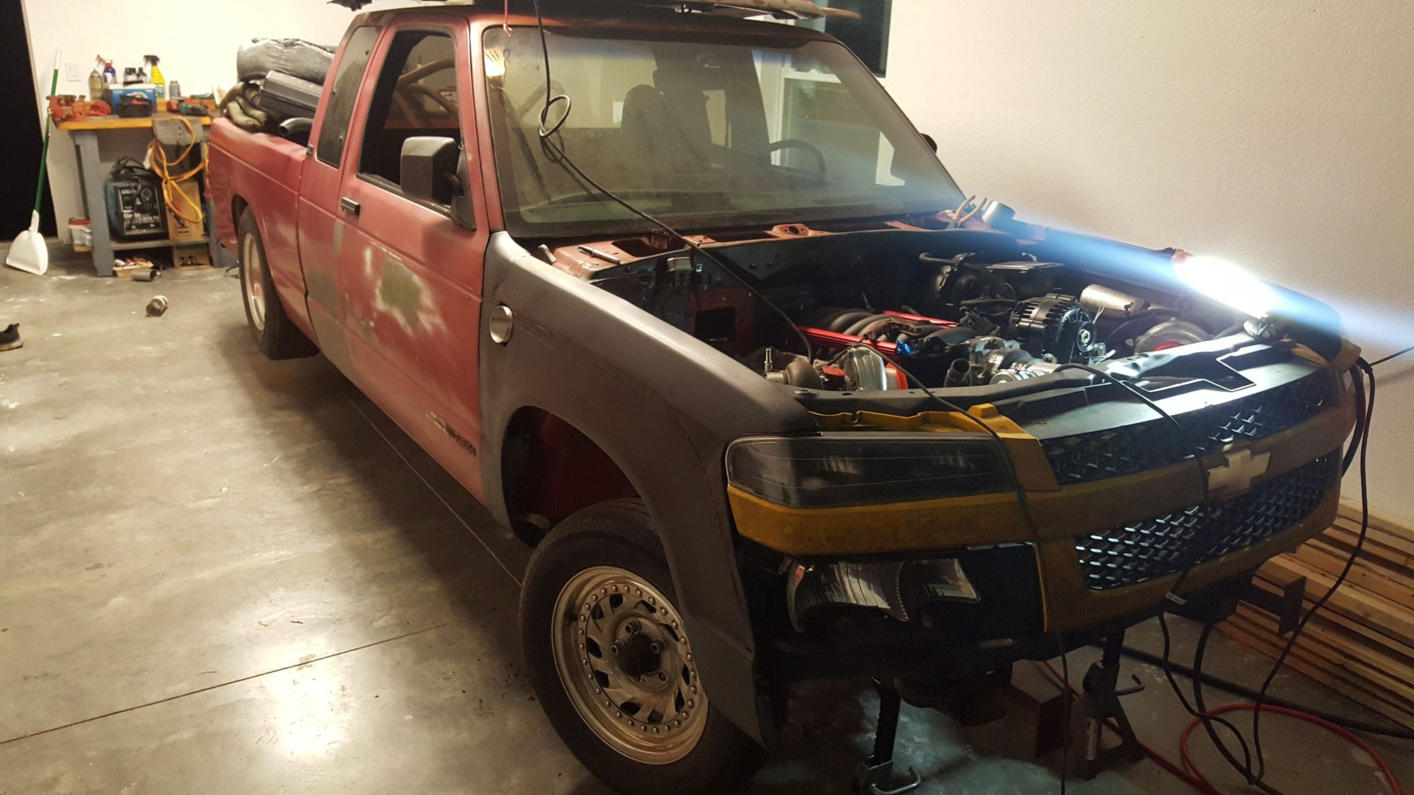

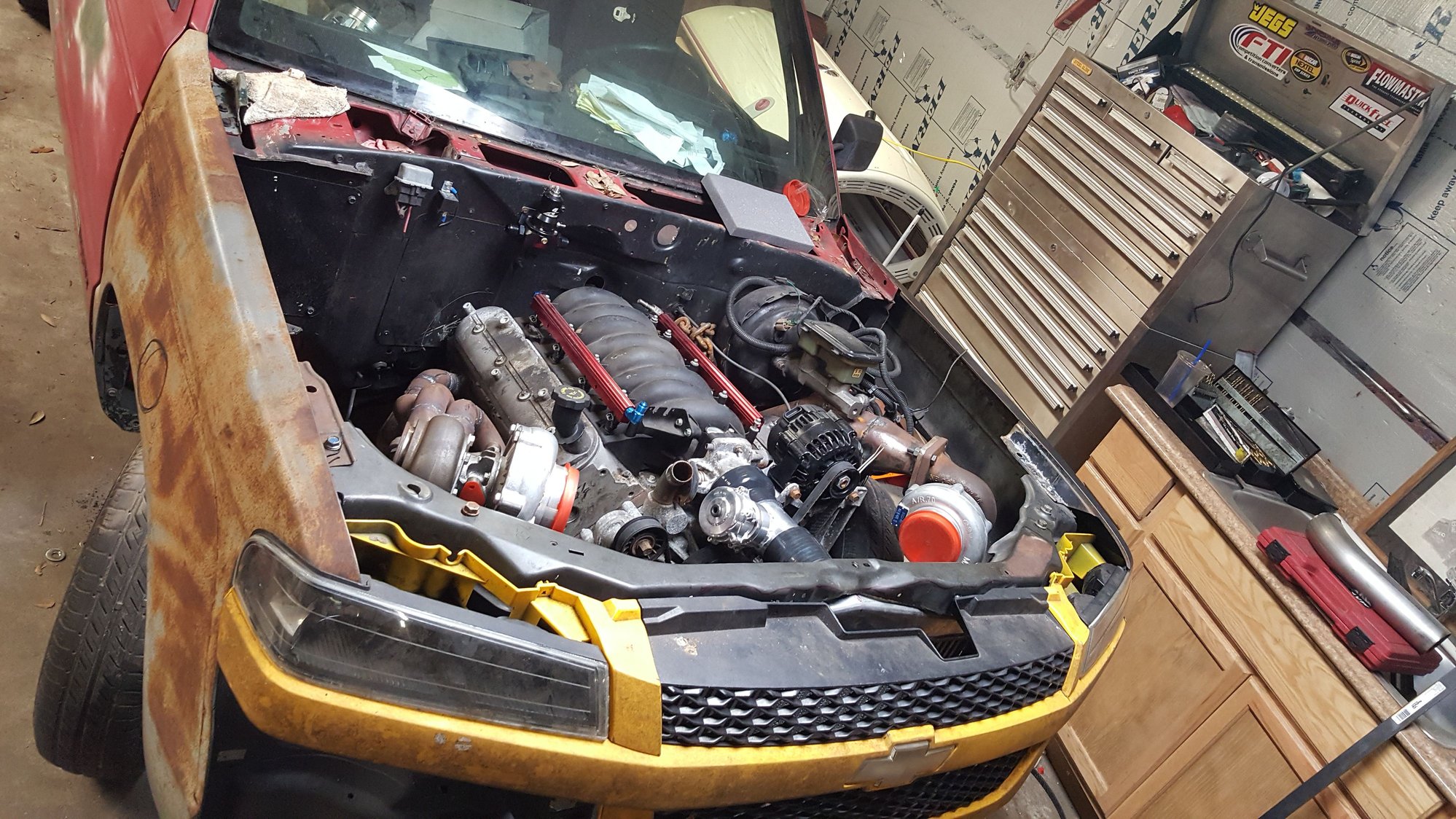

ok so i have a 99 lr4 4.8 im looking at camshafts its in a 93 excab s10 not sure of curb weight around 3400lb would be close
twin 60mm no name turbos
powerglide with a brake
4500 stall
8.8 rear with 4.10 gear
862 heads
rod bolts
head studs
i see btr has a stage 2 4.8 cam but seems small i want to make as much power as i can with wat i have but at the same time i dont want to by a cam just for a 4.8 later on i might build a bigger motor would like to use the same cam i will drive some on the street but am ok with it being on the extreme side
