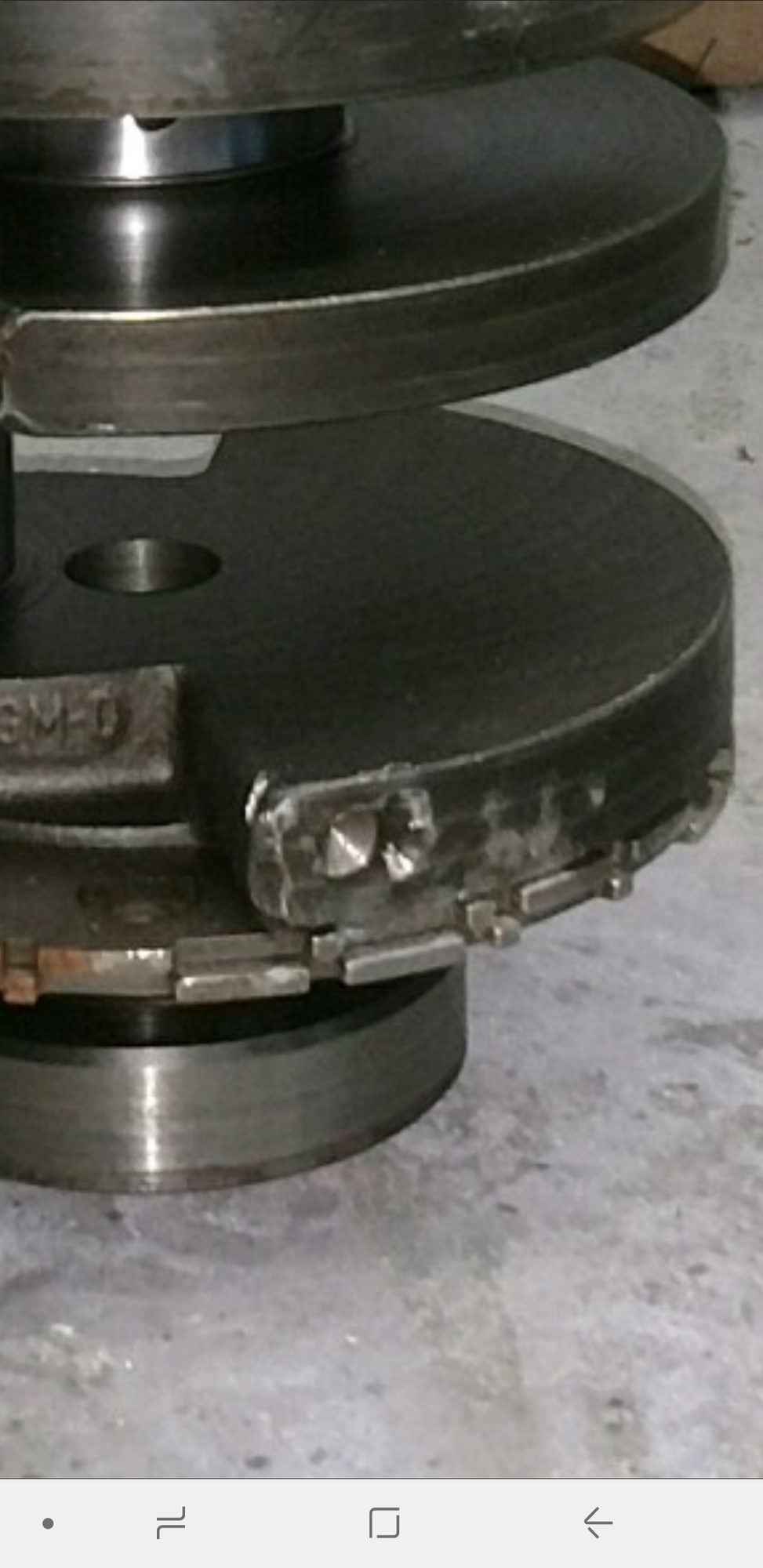

I have ls1 crankshaft that has some damage to counterweight. Can i reuse this crank if i have it balanced or should it be junked? Thanks

How did it get damaged? Is the reluctor still 100%?

Not sure I would trust that reluctor.

Shouldn't be an issue. Let a machine shop inspect it for you.
Clean up any sharp edges. Make sure to have the reluctor checked for run out. The reluctor used to be around $25 new. Maybe have it swaped out.

As long as the reluctor wheel is straight, the damage to the crankshaft itself is just cosmetic and won't hurt anything.
