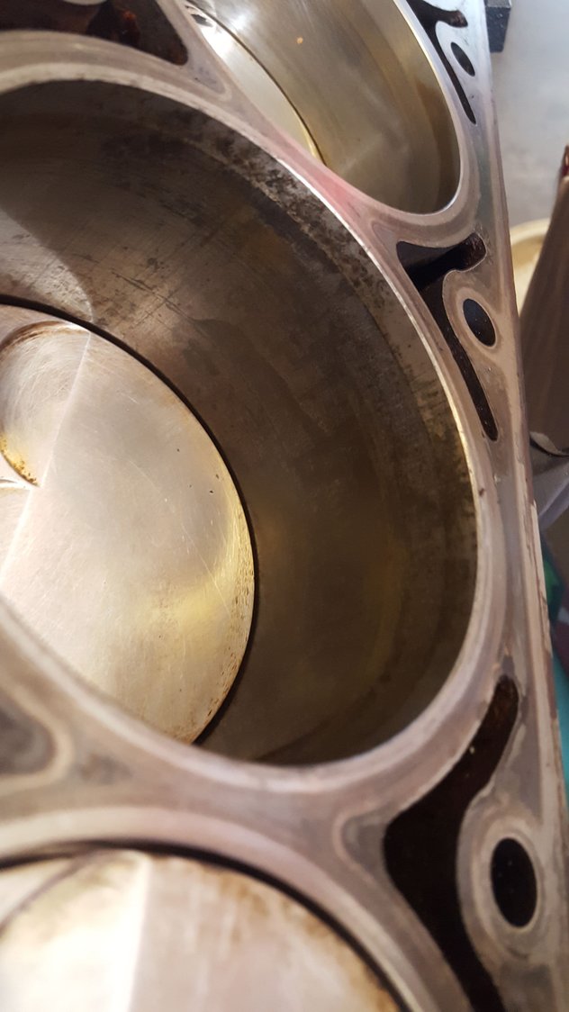

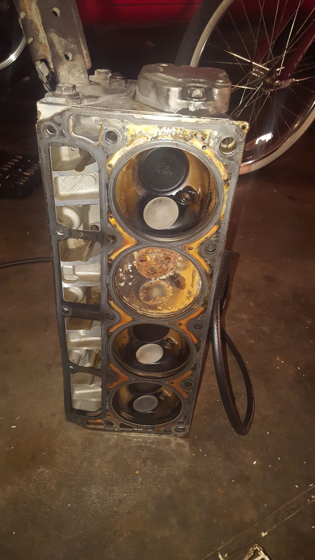

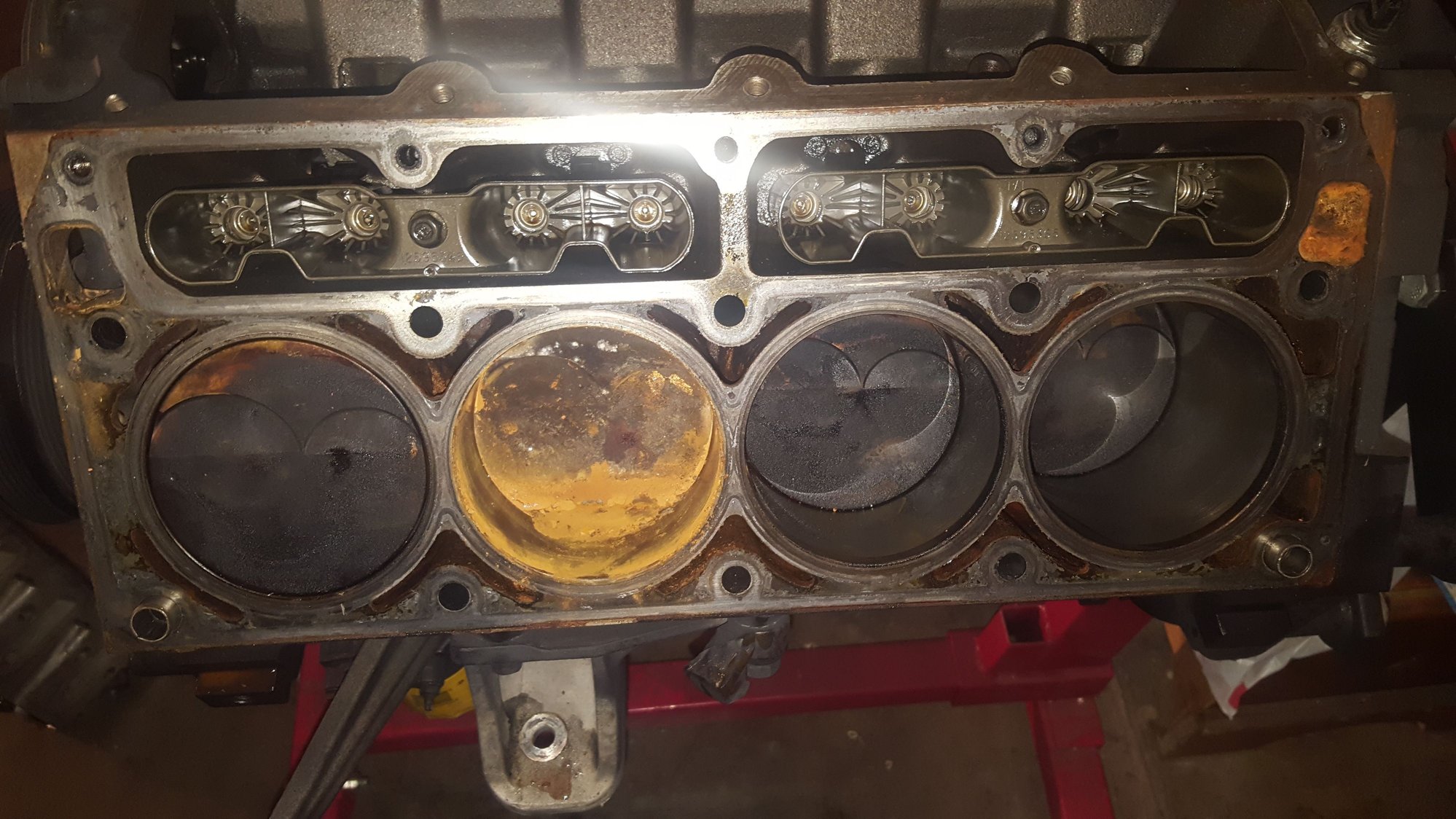

Recently I purchased a (used)2003 lq4 built in corpus Christi. The 6.0 was supercharged and was in a 2006 Goat. When I took the heads off, I could tell water had made its way into one of the cylinders. The machine shop said that the valve seats were nearly non existent, so the 243 heads got a valve job. Then i fliped the engine around and made a short video, looking for some input. I have a 98 z28 camaro with ls1. The reason I purchased the 6.0 was due to the fact that one of the stock head bolts broke off in clynder number 1, and I could not for the life of me, get that bolt out. It broke off in the verry bottom with the last inch 1/2 in the bottom of the hole. I'm wanting to take the ls1 to a machine shop to get the bolt out eventually. However, considering the engine has over 160k, it would be wise to rebuild it before putting it back together. The main task right now, is making sure this lq4 is good to go, so I can drive her again. I miss playing with the stick. Link to videohttps://youtu.be/hu9HAzzanfI

I guess I'm confused on what you're really wanting to know, Obviously the water damage to the cylinder isn't normal and rust damaged cylinder walls aren't good either. If you're wondering if it will run that way then I would say yes but how well that one cylinder seals is not going to be evident until you actually get it running. Nobody is going to be able to tell how bad the damage is from the pictures.

Take bottom end to machine shop and have them inspect that cylinder and see if it needs to be honed. While they have it have them check the balance on the crank to see if something is off, i'd be concerned with that funky hole and there maybe being a balance issue. Have them balance the entire assembly as well.

I would have used some transmission fluid and scrubbed down on that bore and seen what underneath. Might have just been some surface flash. As for the side to side clearance like others said, that's fairly normal and the side to side spec is actually .004 - .020 so there is a wild variance that is acceptable. As for the end of the crankshaft plug, yeah looks kinda hackish. Not sure if like others said a piece of heavy metal fell out, or when the machinist was drilling the block to balance he had a dull bit and it snagged and did that. Its ugly, but if the assembly is balanced it's not gonna hurt a damn thing.
