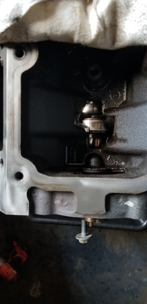

just a side glance to make sure they are all present
