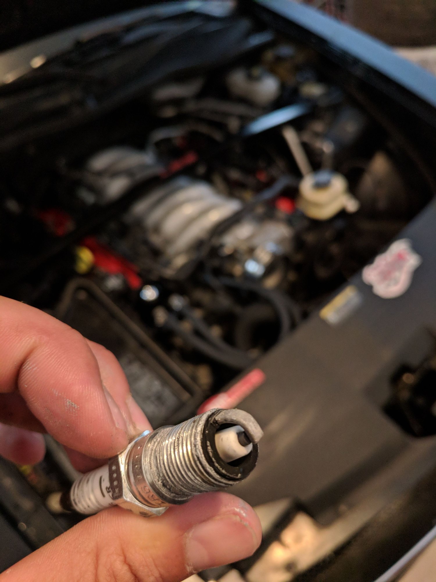

Here is what plug one looks like.
Old Jun 8, 2018 | 06:27 PM
Nazark_18's Avatar
Joined: Apr 2017
Posts: 64
From: Muskegon MI
Heat range looks good to me. Ignition looks off but I'm running 24 degrees at wot .the plugs have been there for about 1000 miles.
