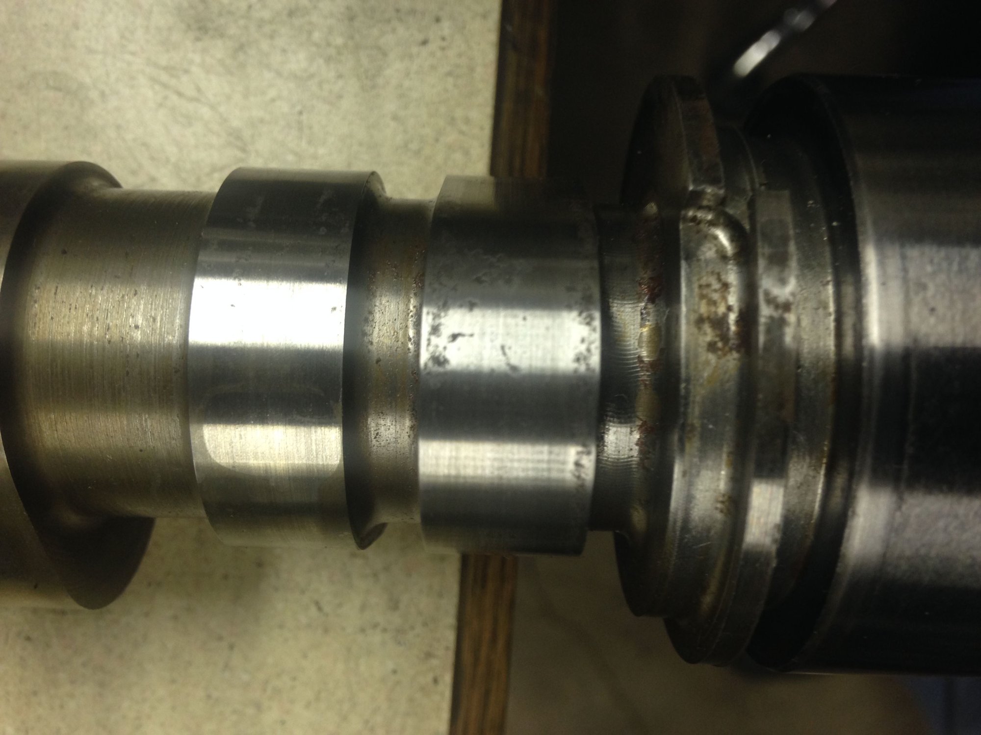

Guess this is a moot point now since I got everything but the cam has some pitting on a couple lobes. Everything else looks great though. Guy at Speed Inc said if you can feel it with your fingernail it will have to be machined.
It's the earlier ls2 3-bolt cam. So if I did have this cam "machined" it would be a direct swap with no ls2 cover/sensor required?

Emailed speed inc about it and yes, the cams are ground by comp cams and he said I can send it to them and they weld and re-machine it for any pits, like 100-150 bucks to do it.
Yes it would be direct swap since the cam sensor would read off the rear of that cam, no need for the front cover and sensor.
100-150 isn't a bad price for a good cam. If they put it through the original hardening process it would essentially come out as a new cam when they're done.
