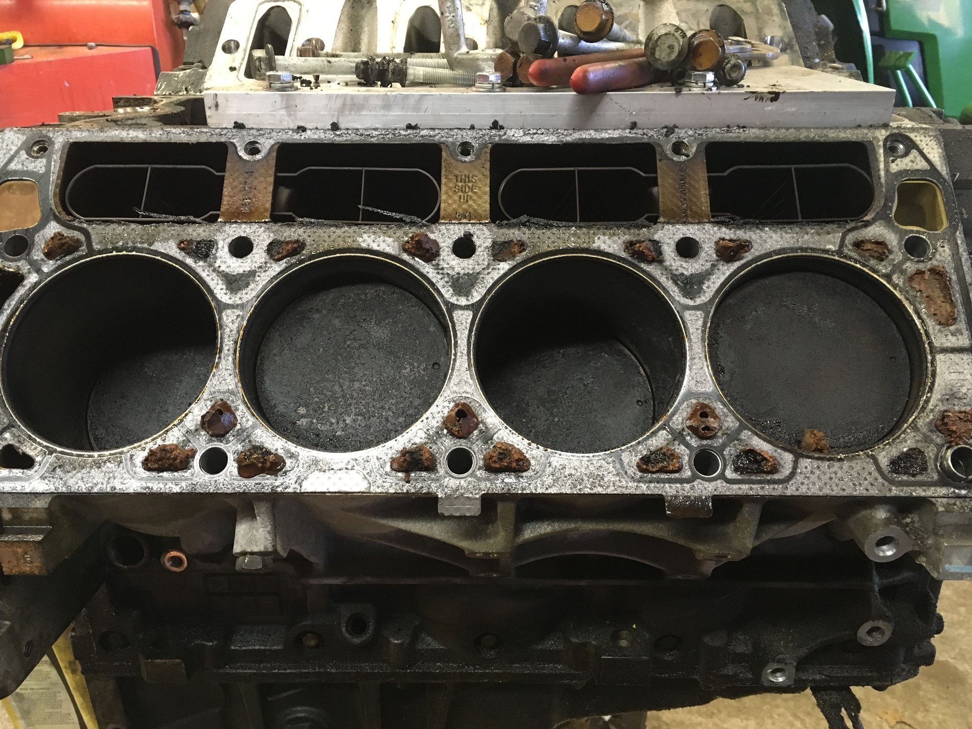

I will be posting more pics later but here are some showing the block. Haven’t always been on top of my maintenance and it shows.

Ooof. Yeah, she’s gonna need a hot tank. Make sure the shop your using has a torque plate for the LS engine. Believe it or not, 21 years later, some shops still don’t have one.

Nice!
