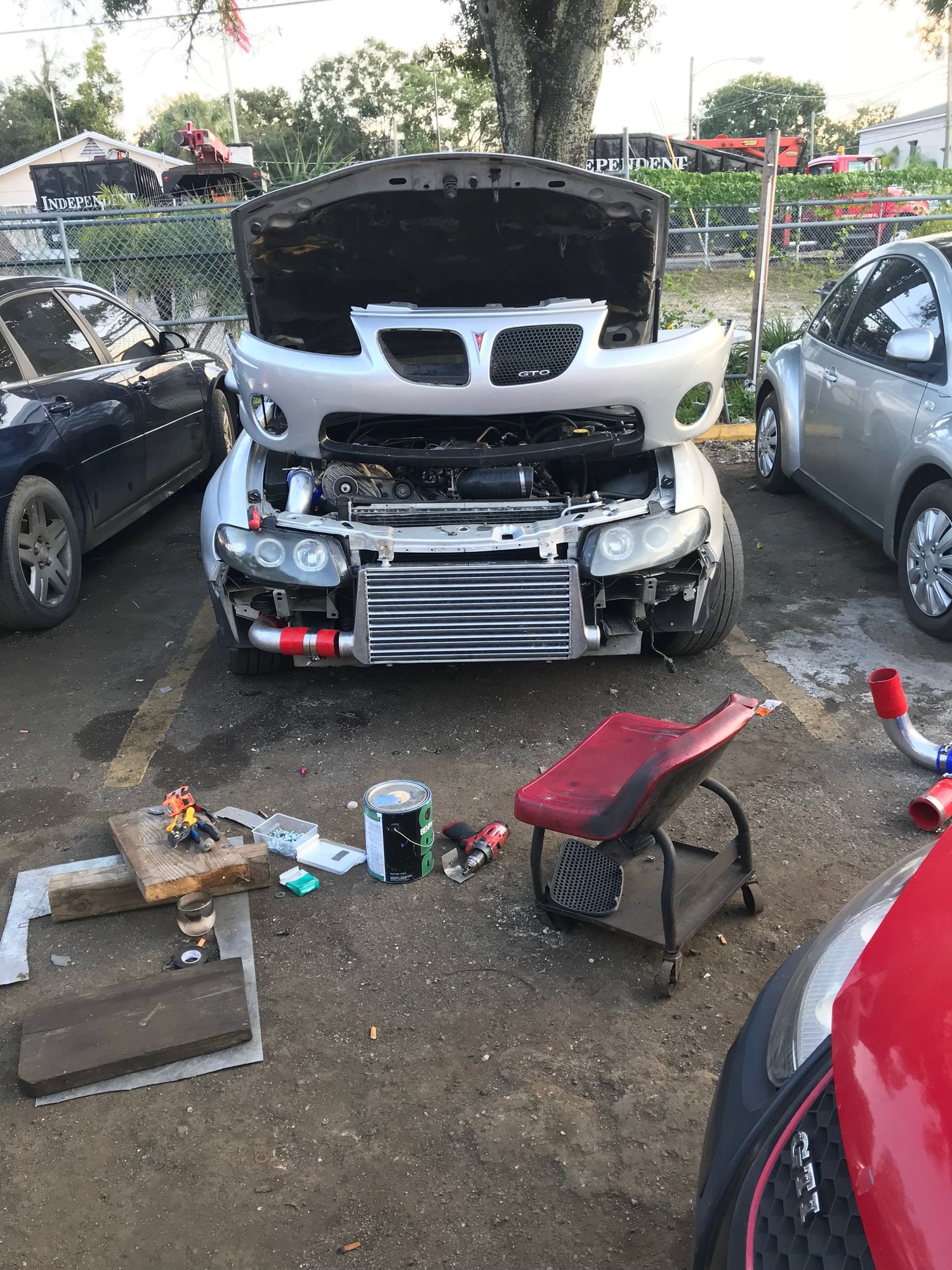

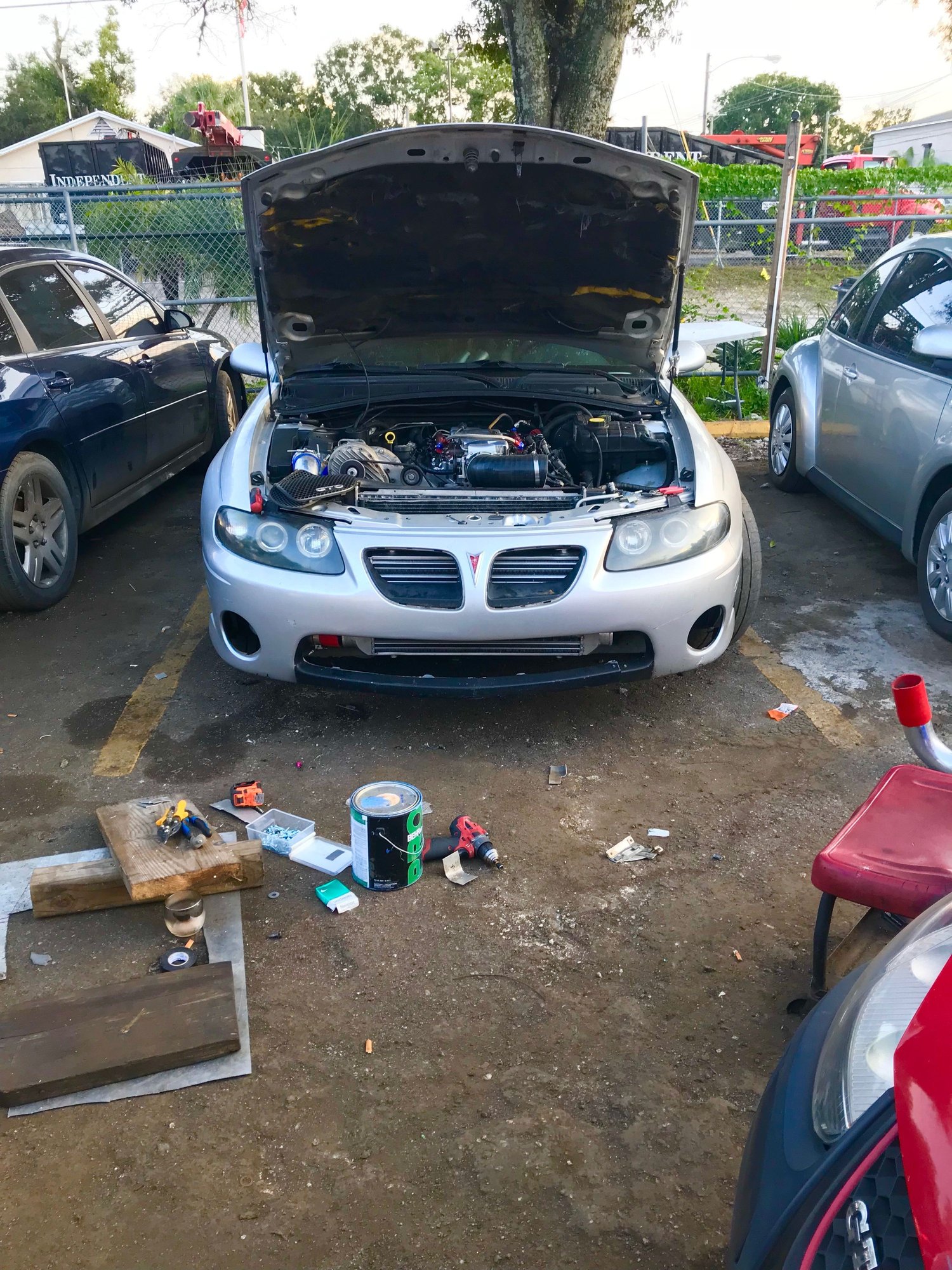

Can you delete the blow off valve temporarily? You’ll need to do process of elimination. Maybe the blower is too small for your engine but I doubt that would keep you from seeing at least a little boost. Are you using a 2 bar map? Is the ve table scaled for higher than 105kpa? Are you using a boost guage? Are you running real rich? What’s your timing at? Who’s tuning it? Can you by pass the intercooler? Do you have an intake leak? A lot of aftermarket intakes require you use flatter bolts in the valley cover. If you don’t it holds the intake up ever so slightly. I had this happen to me once not knowing. Did you block off all of the vent vacuum ports or put check valves in the ones that need it? My throttle body had a fitting that connected a hose from the valve cover to the throttle body for crankcase evacuation. I had to block that off and vent the crankcase into a filtered catch can. Can you post pics of your install and setup?
Im using a power dyne bd-11,Yes ive already deleted the bov temporarily. I have a map sensor with 0102j06 numbered on it, not sure if its a two bar though. on the scanner ive scaled the max kpa to be 155 on the table. im using a bosch mechanical boost gauge too, im not running rich from what i see. timing is around 15-16 at idle, 35 after 2000 rpms, no one is tuning it , i just have it hooked up to a obd2 scanner in live view mode.I bypassed the intercooler already. I don't think i have an intake leak, the car drives fine and no issues that an intake leak would bring but i will check the intake for leaks thoroughly tomorrow after work.
i blocked all open vacuum ports, (ran the hose from left side of TB to driver side valve cover to the pcv valve, passenger side valve cover vacuum port has a small breather on it) i tapped in my boost gauge to my brake booster line coming out from the back of the intake. where would i need check valves at?
here are some pics of when i was putting it together. ill see if i can post some videos too.
