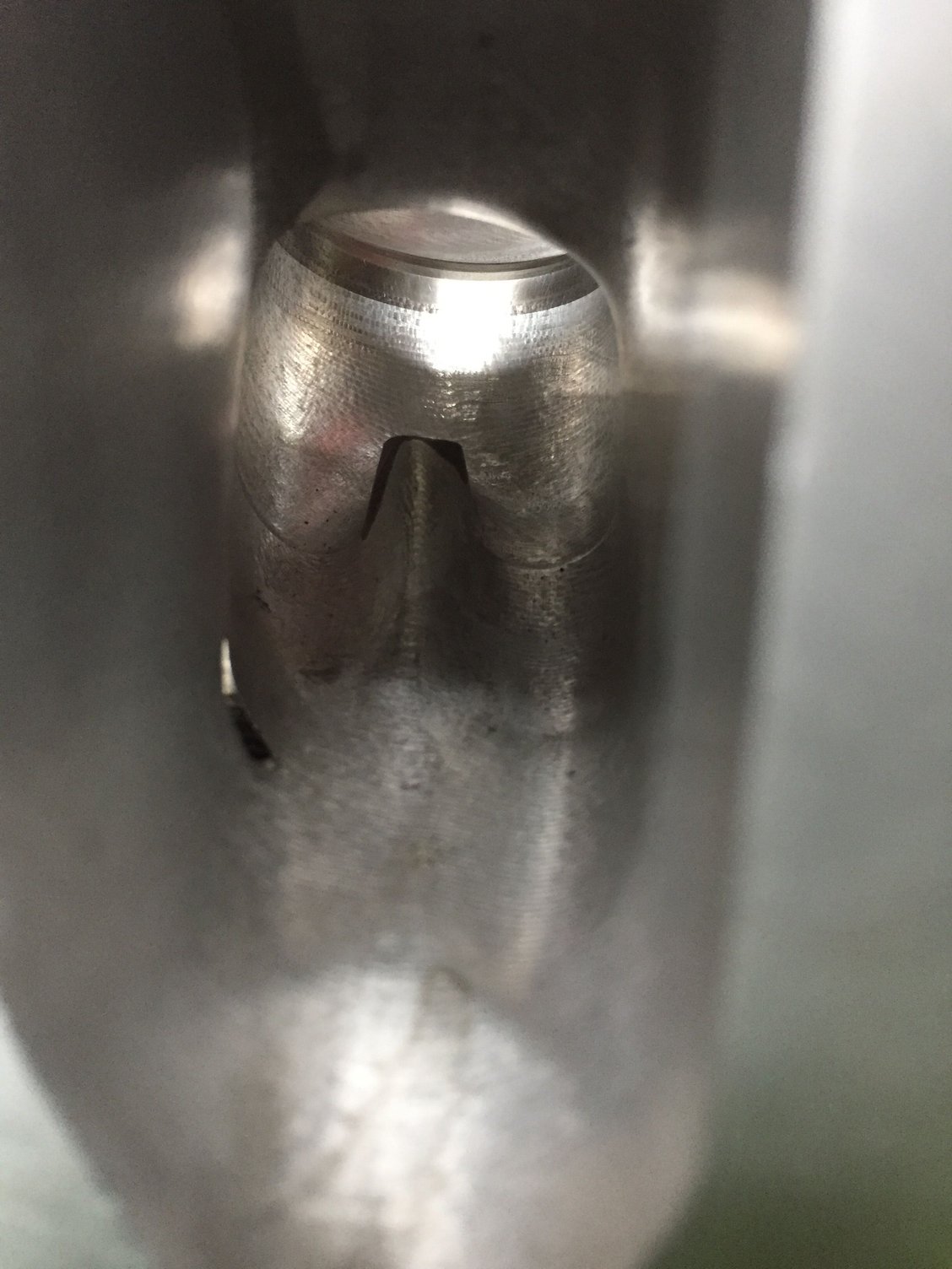

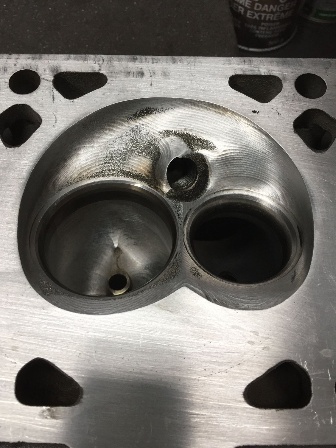

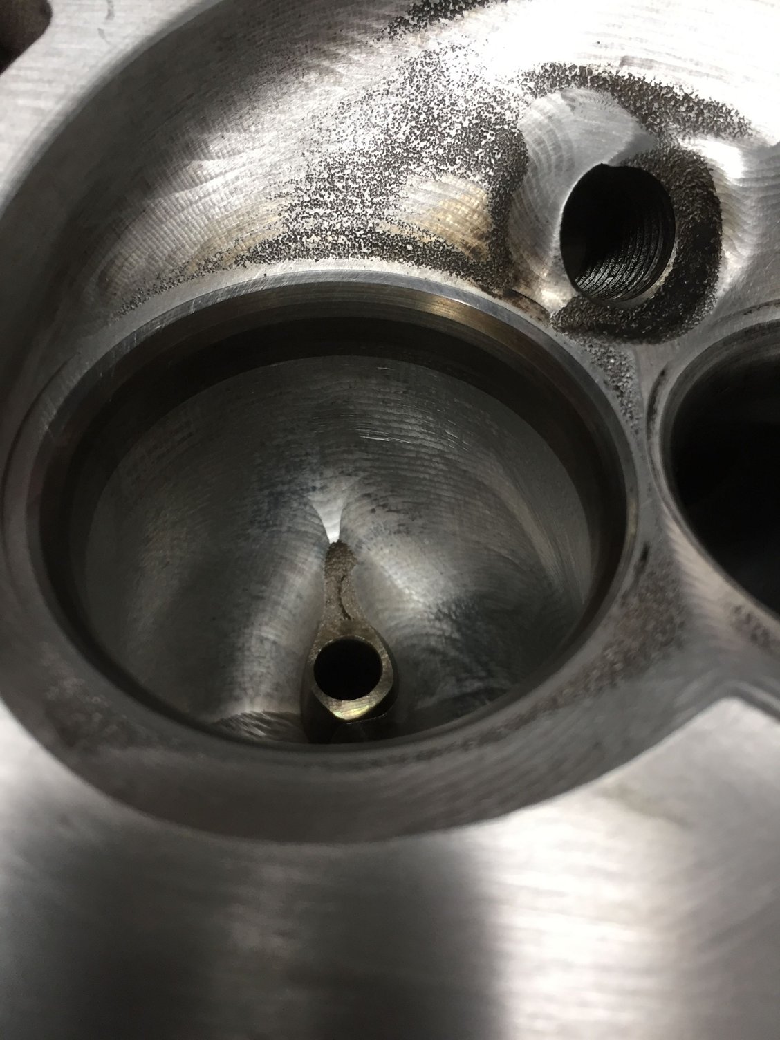

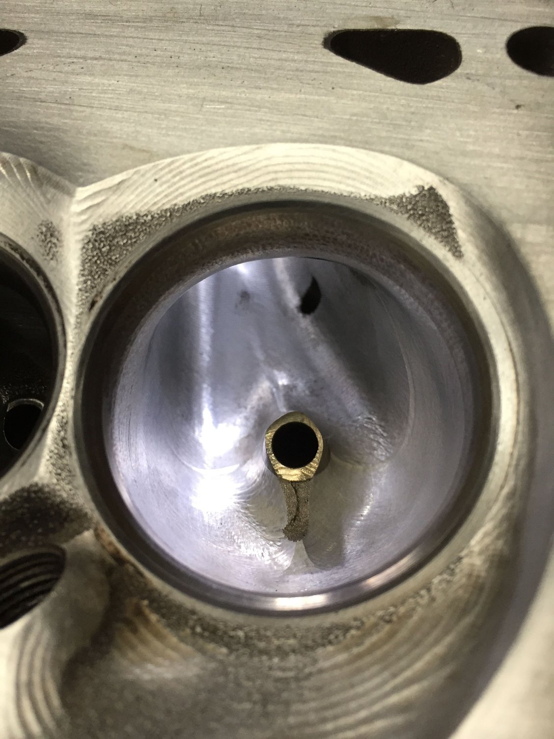

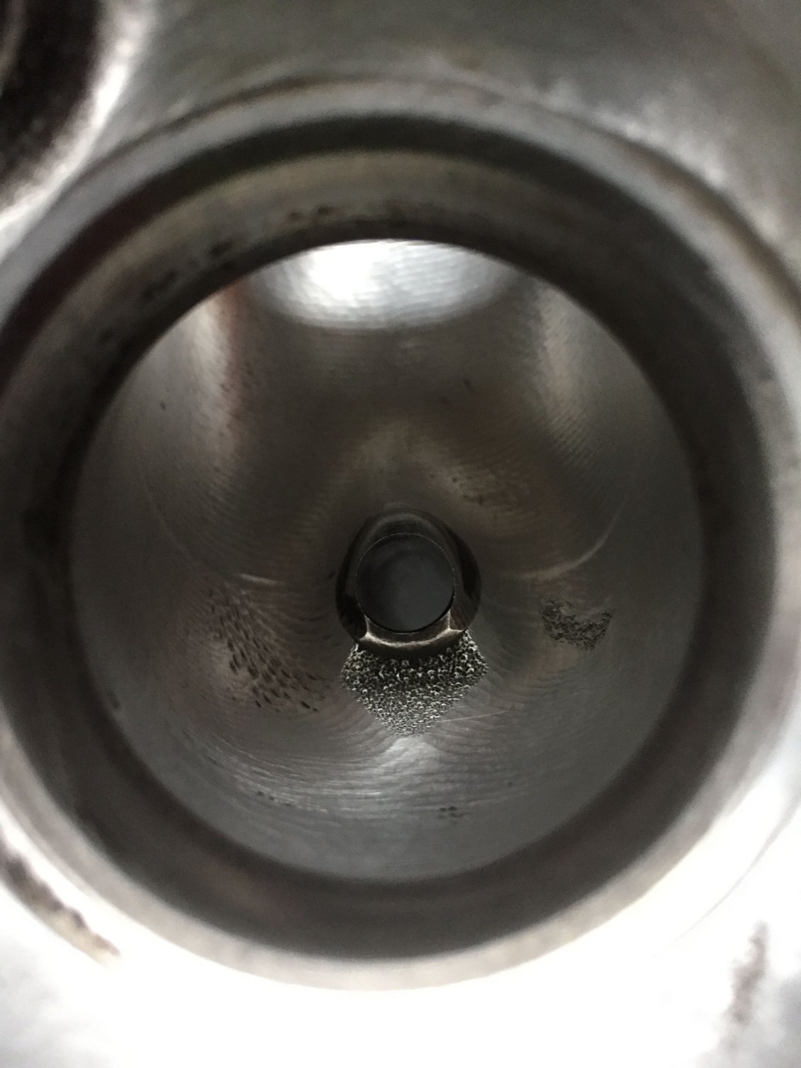

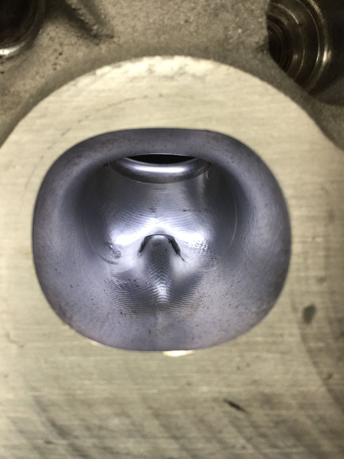

Chamber
Chamber
Intake
Intake port
Exhaust
Exhaust
Thank you KCS for your expert opinion, it means a lot. To not affect port flow I guess it’s better to stay with big valves.
Lately I did a lot of reading about valves, shrouding and velocity to come to conclusion that 2.055 valves are too big and too heavy for nothing on a stock bore LS1. In my case, I have to replace intake valve seats, because outer edge of 2.055 valves seat on aluminum, so I thought of installing stock 2.00 valves. I just don’t know if the rest of the bowl is opened too big for smaller valve and how this will impact the port flow.
Any opinions about port work? Good or bad?

Well from the pics those heads have a top shelf program on them . As for the valve size , for argument sake let's say 2.04 is a ideal size for a 3.9 bore your not that much bigger. What makes you think the valve job was not cut for those valves.I would dyecum the seats and lap them, have you measured the throat diameter ? The REV valves are good , I'd run the 2.05 you have .
