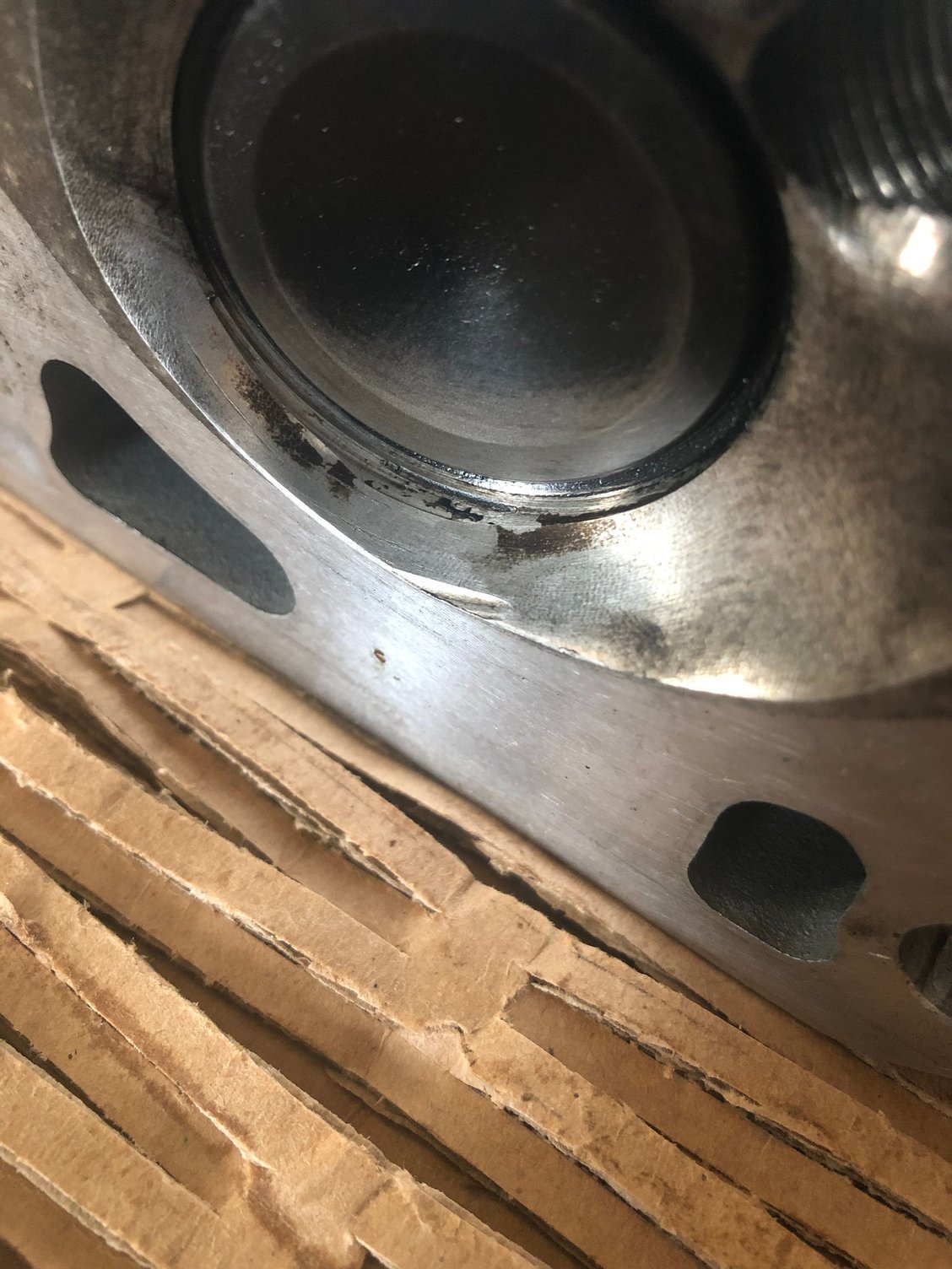

As the title says, there is a decent gouge beside the exhaust valve, nothing too severe, and the gasket mating surface appears to be untouched. Im leaning towards bolting it up. Thoughts?
PRC 225 as cast 62cc
Thanks in advance

Looks OK. Go ahead.

I agree.

IF there are any rough edges to the nick maybe smooth them down a bit to eliminate any hotspots that may occur. But yeah, use it!

Knock down any rough edges, if you want, and run it. I wouldn't worry about that at all.

Full send

What they all said. Make sure you get rid of sharp edges, let it eat.
