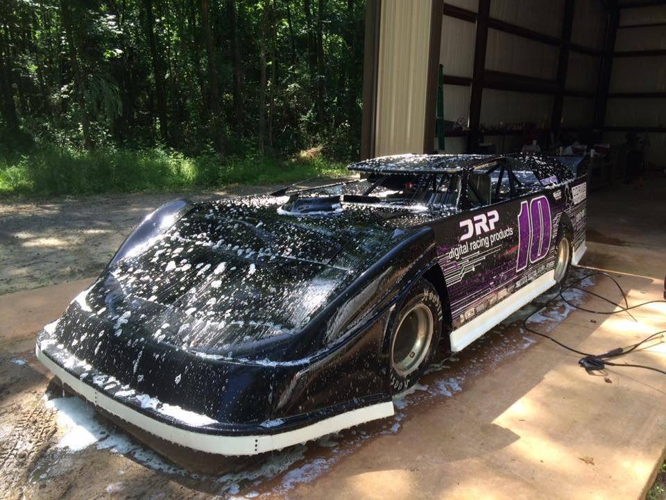

I'm not too concerned about power below 4k. This is circle track dirt racing and we won't spend much (any ?) time that low. I'm racing against 604 crate motors, some of them cheated-up a bit, to the 480 HP range.
car is very light, 2300 lbs wet *and* with me in it, and we change the rear end gearing to suit conditions for the track.
i like the cam and spring combo packages that summit has now. i was a bit worried that it might be a little too much cam but i've fallen into the "bigger is better, right?" mentality
this is the car it's going in. i'm pulling out the 800 HP open motor and dropping in this budget LS to do some local racing and get a bunch of laps in.

Nice 3 wheel ! I'm running a late model around Arkansas.
Photo above ^^^
