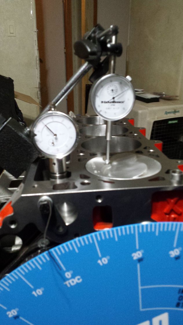

BTW when No.1 is at TDC so is No. 6. So in you should be able to measure PR length for the intake and exhaust for both of the those cylinders as the cam lobes "if the cam is installed correctly those lobes will be on their base circle"

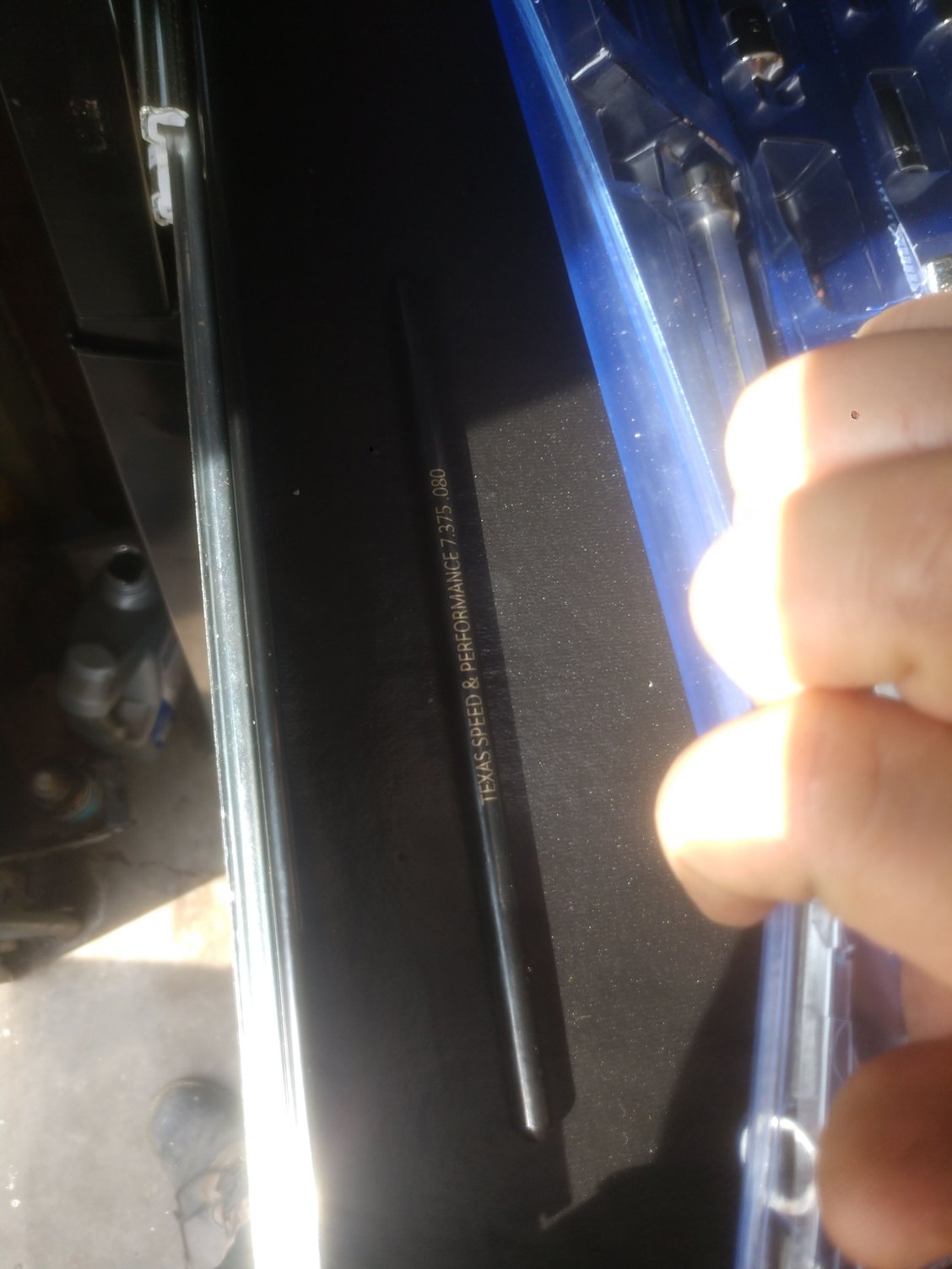

Yeah I'm learning now that the cam can be in 2 different spots when TDC... Either 12 or 6 o clock. The video I watched (watch me wrench is the guy), he checked the length with both cam and crank in a 12 o clock position. I checked it again and came up with 33 turns, putting me at 7.28 +.08 would 7.36. I could make the Texas speed pushrods work but that's putting the preload at .095 ( found the other btw... Rolled under one of my trays in my tool box.
so here's the scoop.... Pushrod measured at cylinder 1, TDC with cam dot at 12o clock... Intake valve side was measured...33 turns for Zero lash... 7.28 is the measurement. With preload of .08 it's 7.36 or preload of .095 at 7.375. I hate asking redundant questions that I'm sure "just Google search" or "read the instructions" are the answers that are due for my silly misunderstanding... But it's new to me, I'm still trying to grasp the idea of measuring the length and EOIC, etc... Thanks again you guys. If you were local, I'd buy ya a beer haha 🍻

Yeah if you measured another cylinder and came up with the close to the same result then I'd say you have it.

The cam gear will only go one way and when the dot on the crank gear is up and the dot on the cam gear is down then 1 & 6 are at TDC but in order to find absolute TDC you need to put a dial indicator on it which in theory coincides with the dot on the crank gear.

I don't have my cam installed into the block yet but I do have my crank in and trust me when I tell you that your cam is installed correctly when the No.1 cylinder piston is at TDC which is all the way up as high is it will go, Once you turned the engine over to reach this point you will notice.
1.) The key on the crankshaft is pointed towards the No. 1 cylinder.
2.) The dowel pin on the front of the camshaft should be to the right in the 1-2 o'clock position when looking at the front of the engine or in other words it should point towards the No. 1 cylinder.
When you finally install the cam gear and timing chain the dot on the cam gear should be pointed down towards the bottom of the engine and the dot on the crank gear will be pointed up towards the top of the engine and the dots will line up. If you want I can post some pictures up later for illustration.

Oh okay.. yeah I figured the cam was in right but just the pushrod issue and the correct spot/way to measure is what's getting me. I ch ecked another cylinder and it too gave the 7.36, so I'm torquing the rockers in the correct sequence now
Actually, they are not. #1 will be at the end of exhaust beginning of intake and any measurements will include overlap of the cam. #6 will be at TDC of the firing stroke and both should be on the base circle. Crank keyway will be at around the 1 oe 2 o'clock position with the dot at the 12 o'clock on the crank sprocket.

There is a missing parameter in this discussion when discussing TDC. TDC is top dead center of the piston, however the cam may not be correctly oriented for the cylinder you are measuring. It must be TDC on the firing stroke to measure, otherwise use the EOIC method.
