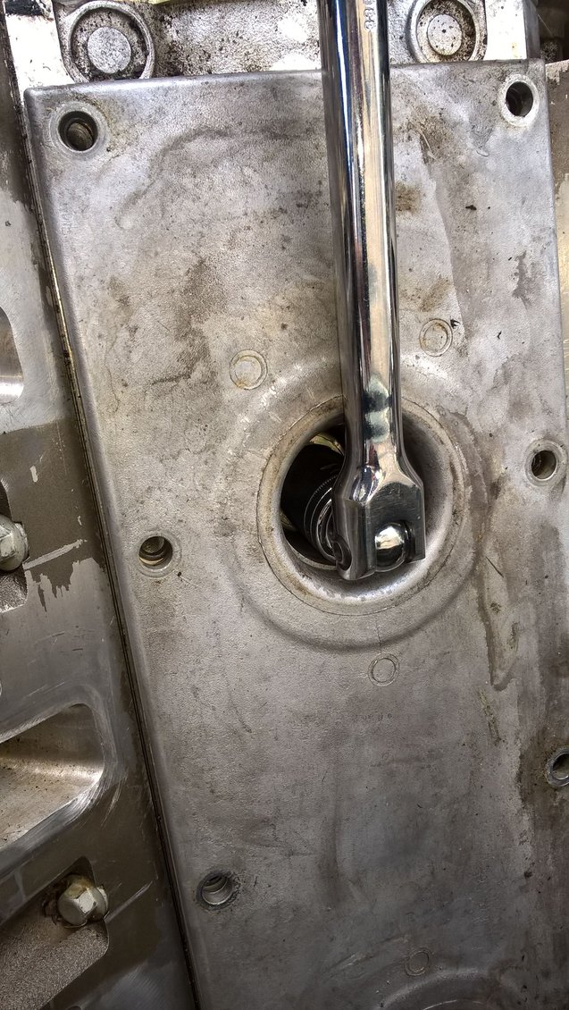

This is what I'm working with:

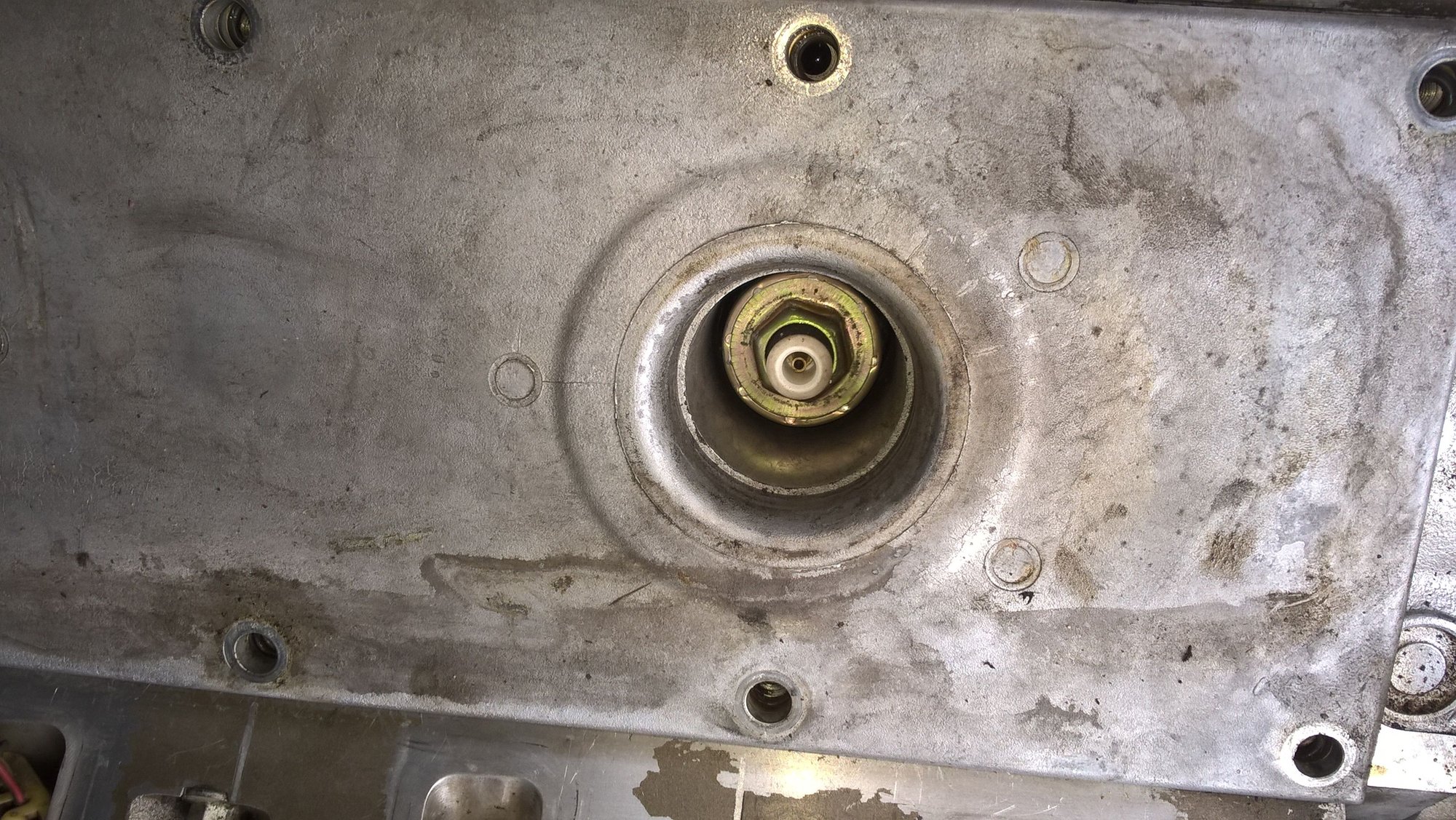

In the top pic, you can see the outer casing, and the inner cap. The inner cap spins, but the outer casing does not. I was expecting them to spin together. They are only a year old, so they are not corroded.
I found several Youtube videos where people just break the torque, and remove the sensors by hand. Well, F- me. Mine **** ain't coming out. I was supposed to be done with this by now. Now, I'm dead in the water.
Any suggestions????

Just stake the sensors on both sides and remove them knowing you have to replace them.

Yeah I don't like them there either which is why the block on my stand will be tapped and threaded to relocate them.

What size is the socket your using?

I was using a 22mm socket. It seems to fit good.
Well, I finally said F-it. I took my 1/2 breaker bar and pried up on the valley cover. I got valley cover off without removing the knock sensors. It sounded bad, but it doesn't look like I broke anything.
