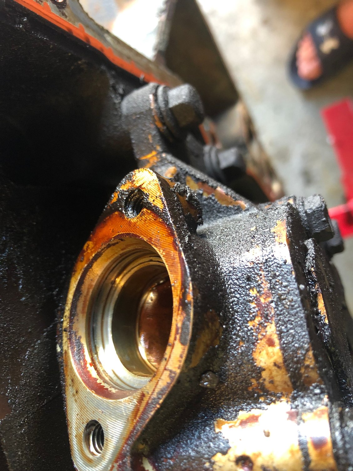

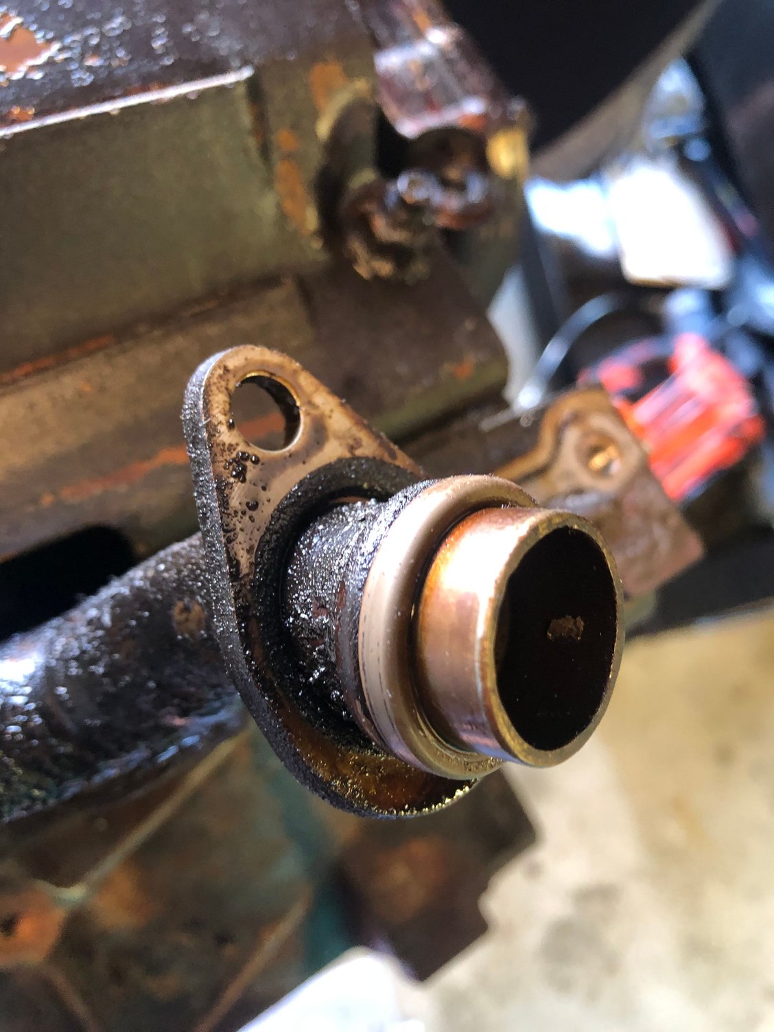

Hi Everybody.
So this is my first LS build and I'm building an LM7 engine. I've read about the oring at the oil pump but couldn't figure out what I should use. The one I removed had a grey seal rather than an oring that was really hard. Is it just the oring that went flat and hard of the temperature or is there a different seal other than the oring I should use? please see pics below and tell me what you think.

To be absolutely sure, it would help to show it without the old O-ring.
Oil pumps are all the same... just a simple bored-out hole. The thing that determines which O-ring to use is the pickup tube.
That looks like the kind of tube that gets the thinner O-ring, with the straight end. The kind that gets the thicker one has a neck-down looking feature.
Easy enough to figure out. Should fit into the pump tight but with moderate force. If it needs the thin O-ring and you put the thick one on it, it won't go in without destroying the O-ring. If it needs the thick one and you install the thin, it will wobble around in there a bit.
It's not a bad idea to replace the pickup tube anyway; and get one of those additional clamps that are out there, that clamp it with the 2nd hole. SacCityCorvettes has one for example. None of that costs much.
Old Aug 8, 2019 | 11:16 AM
Posts: 22,291
Likes: 3,616
That IS the old hardened (and now useless) O-ring. Differences between thick and thin are as above. Really mostly common sense.
