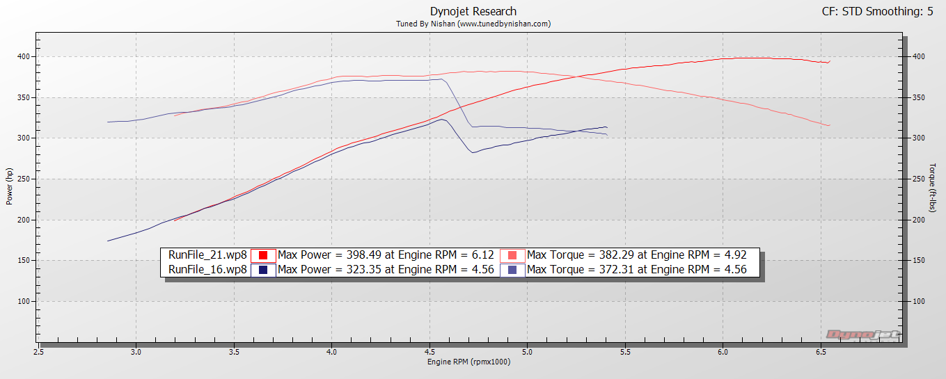

A few weeks ago I went on the dyno for a tune and at around 4500-5000RPM the numbers would drop drastically. When it happened it would sounds like a bog/misfire but the tuner insisted it wasn’t a misfire because all of the numbers looked normal. We managed to get a couple good runs but most of the runs it bogged. I’ll include the graph with one normal run and one bad run.
While I was home trying to figure out the issue, I figured it sounds and feels like a misfire so might as well swap out the plugs so I replaced my TR5s with TR6s. Took the car out for a spin and it felt WAY faster and no bogging. I thought I fixed it but after a couple hundred miles it’s starting to hesitate a bit. Could it be just that he wasn’t able to tune it properly because the plugs were bad and I just need to go back with fresh plugs or is it something else?

Started to misfire
Ran out of fuel
Too much timing and started pre igniting
Those are my guesses.
If it felt better on a fresh set of plugs sounds like it was the plugs. Put in a fresh set right before tuning and take it straight there. Inspect the ones you just put in closely and try to figure out why it got so much better with a fresh set. Look to see if they are fouled from fuel or oil or anything else that sticks out as... bad

Fuel pump/ regulator set up correctly???. At bare minimum a 255 walbro/hot wire kit, and Vette regulator/filter ????
