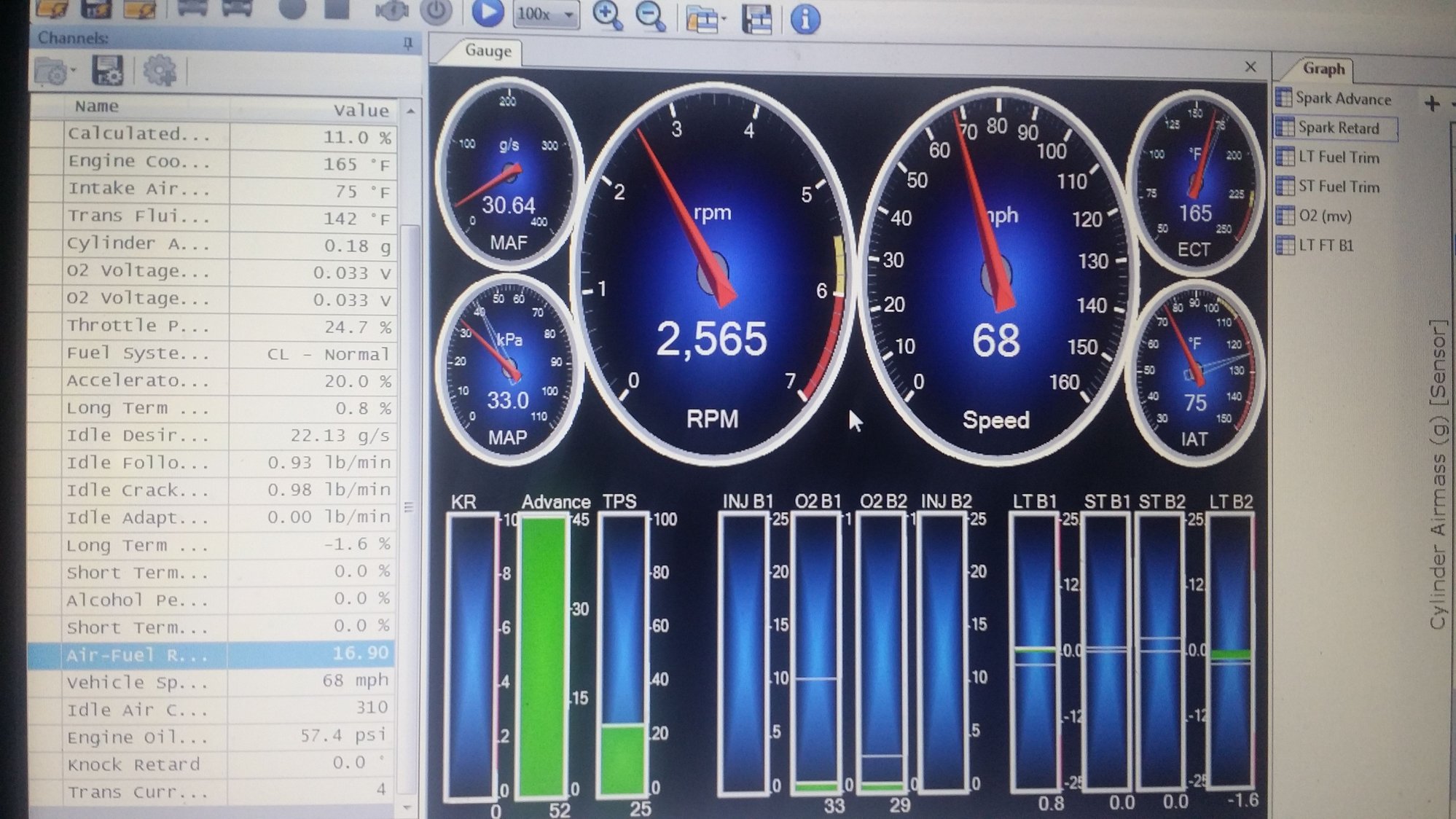

I actually just finished installing a cam, lifters and stock 5.3 heads on a LQ4 and tuning it this past weekend. It was a stock LQ4 with an edelbrock proflow and 2010 camaro manifolds into a dual 3" exhaust with a x-pipe and flow masters backed to a stock 4L80E with the stock converter that stalls ~2,200 rpm. It is shoved into a 71 Chevelle with a 4.10 gear and 325 wide drag radials on the back.
My friend is a cruiser and the car rarely ever exceeds 3,500 rpm. But when he does exceed 3,500 rpm he wants it to go. He also likes it to sound good and have stock manners driving. He wanted more low-end grunt from the 6.0L.
The 6.0L broke a plastic lifter bucket/retainer, spun the lifter and ate the cam. After several weeks of conversations about what to do. I talked him into a pair of junkyard 862s that were cleaned up, valve job and decked 0.020" by a machine shop. BTR double springs. For the cam we went with a cheap 228/230 Elgin. For the lifters we went with Rhoads original. Once it was back together and tuned, it makes more power everywhere. It has a slight valvetrain noise that resembles a tightly lashed solid roller cam. The knock sensor does not pick up any of it. With the MAF disabled I had to add fuel practically everywhere to the VE table for the increased airflow of the cam. Slight tweaks of the MAF and timing tables. Car idles at 550 rpm with 18.5 in/hg vacuum. When you put it in gear it maintains its smooth idle. When you pull away from a stop at light throttle the 80E shifts into 2nd at about 5 mph. Shifts to 3rd at about 15 mph and into OD at 23 mph. Then locks the converter about 33 mph. Give it more throttle and it shifts about 3,000 rpm and it is already building enough torque to shove you nicely into the seat. At WOT the 6,200 rpm shift points come quick and it has more than enough power to easily break the 325 drag radials loose. I tuned the car with a wideband. I enabled lean cruise and it runs at 16.9-17:1 at 2,600 rpm at 70 mph on the highway while pulling 19 in/hg manifold vacuum. On 87 octane it runs 26° total advance at WOT and up to 52° in lean cruise. You could not ask for a more balanced, spirited cruiser. We cruised it 150 miles on sunday afternoon. Car had previously gotten a best of 25 mpg. On our highway cruise it averaged 29 mpg.
If you consider a cam, consider new lifter buckets, a higher lift cam, double springs, and rhoads original lifters. The original rhoads lifters will knock about 15° duration off the cam at lower rpm and save yourself the aggrevation of losing low-end torque and idle vacuum yet still give you the top end charge of the cam you chose. At idle and low rpm that 228/230 cam is like having a 213/215 cam.
Just showing how effortlessly the car cruises down the highway with all the low-midrange torque this setup makes.
