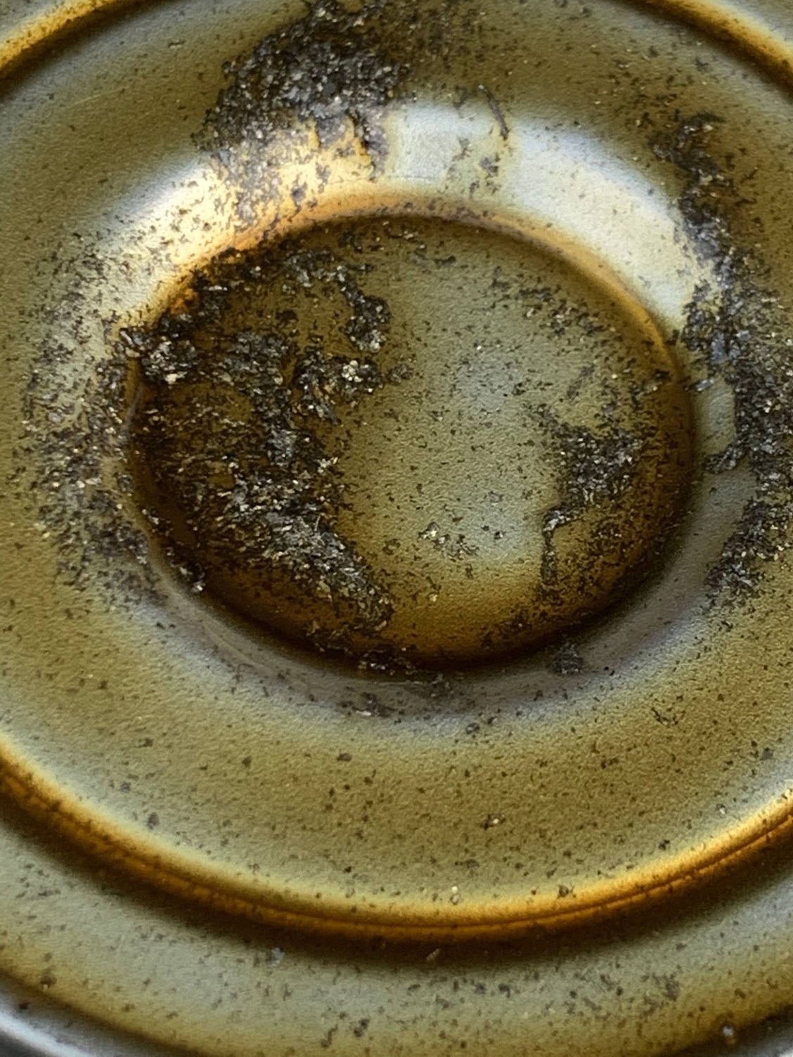

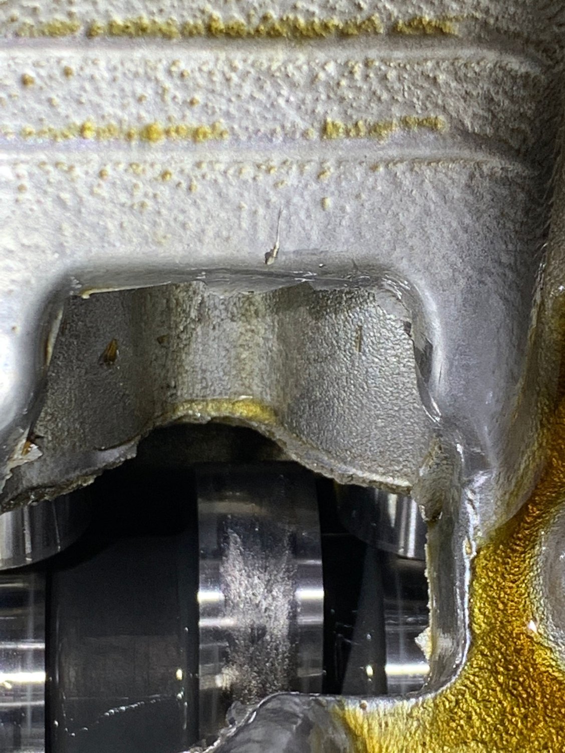

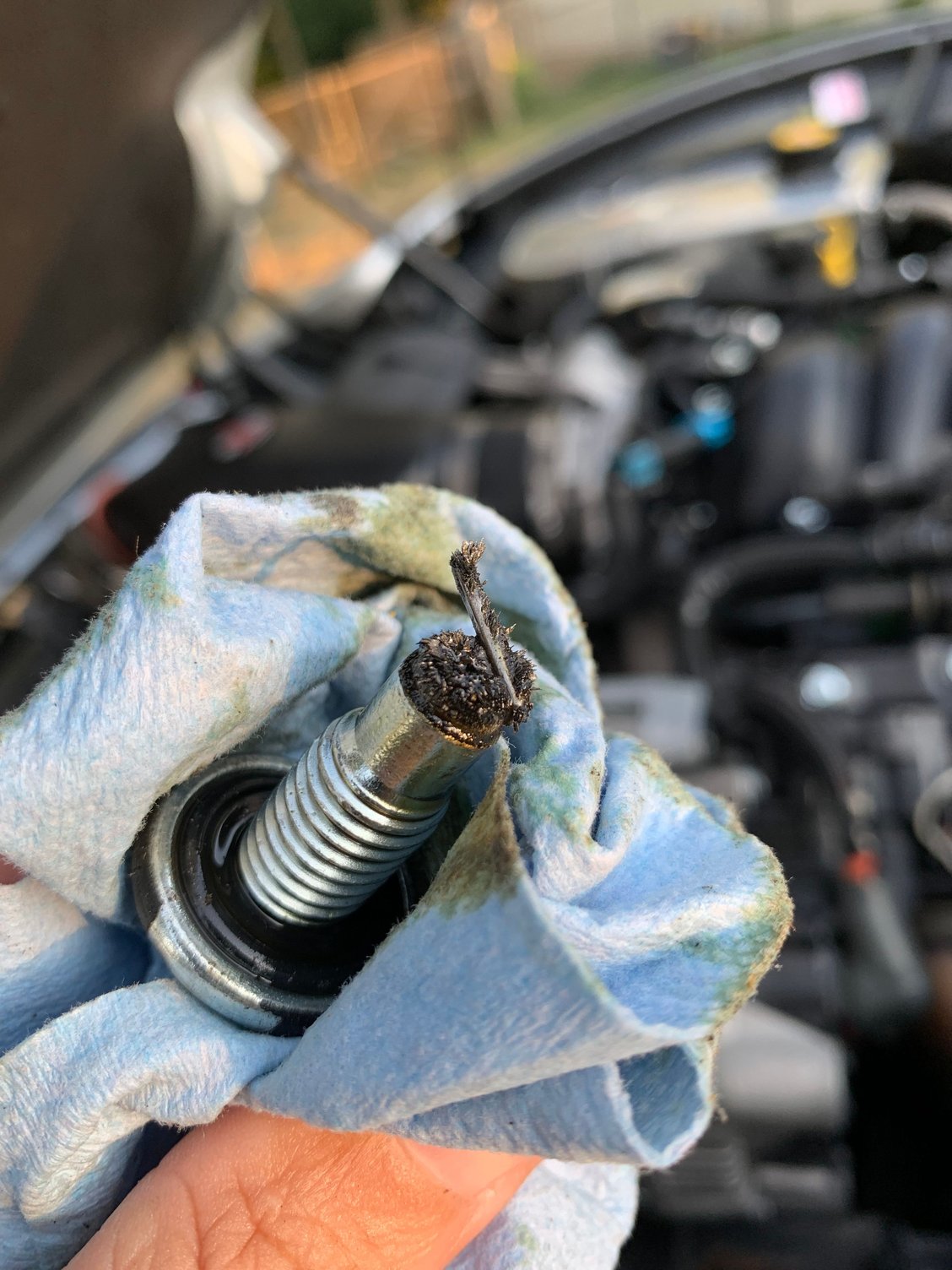

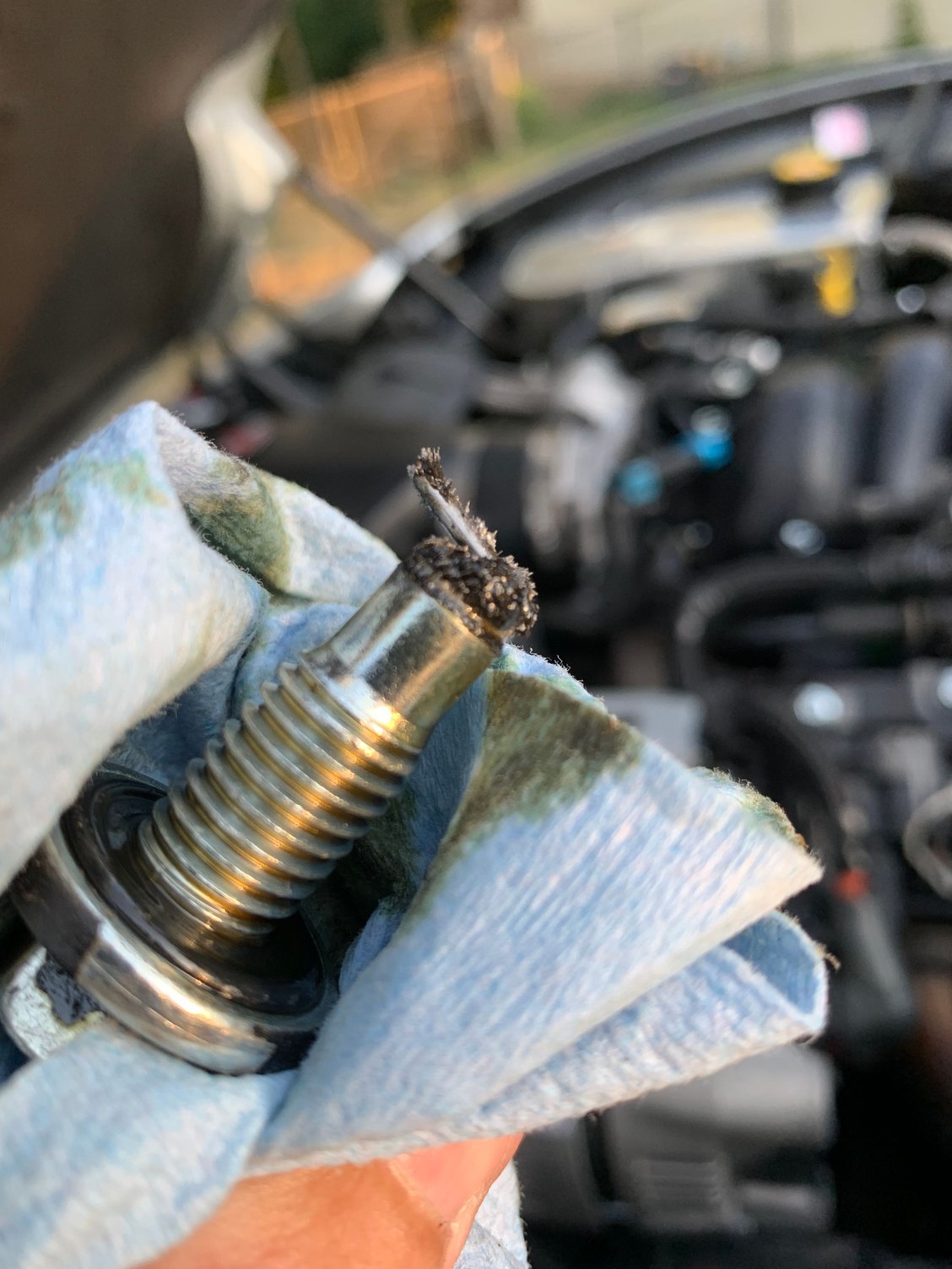

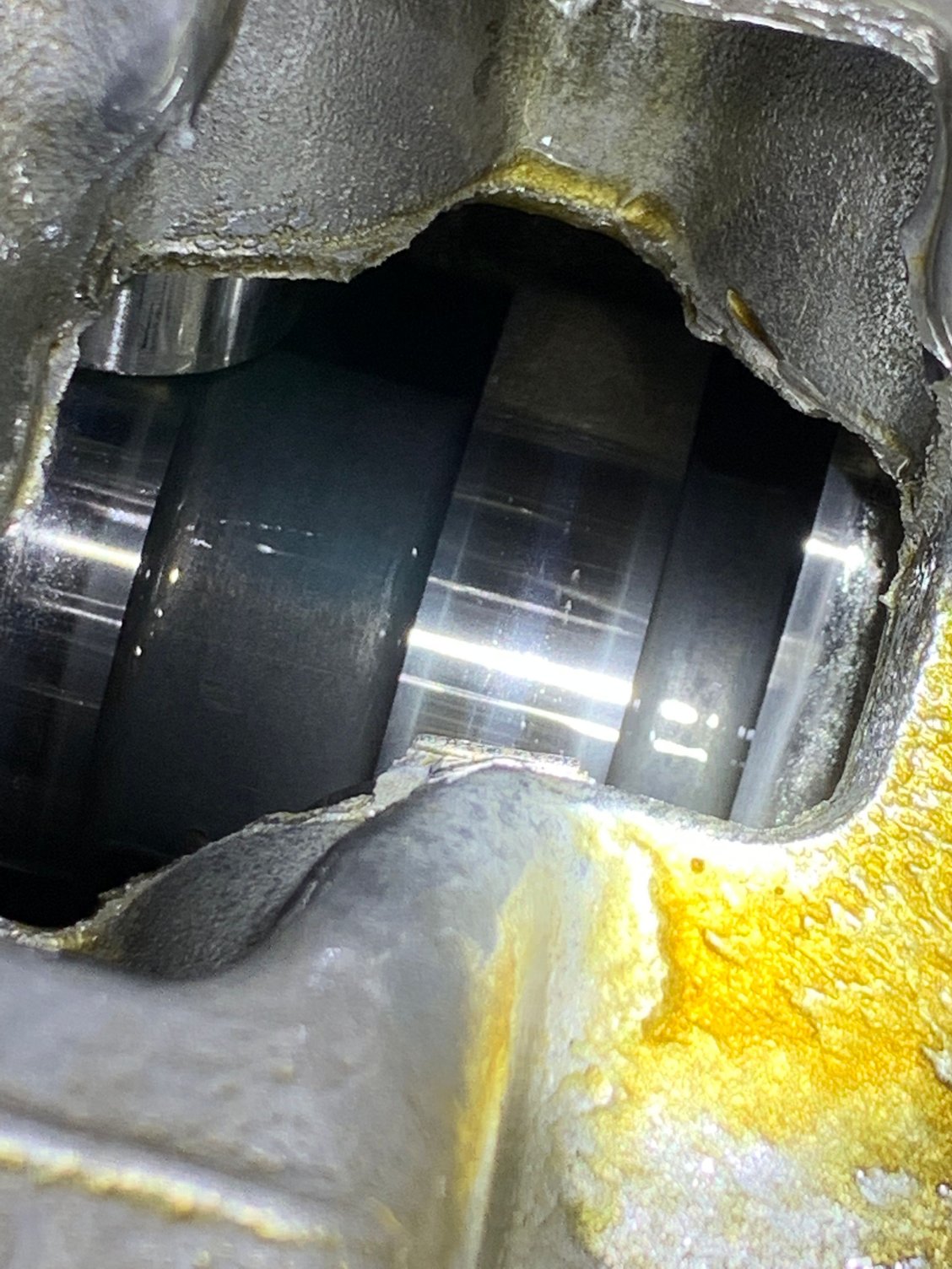

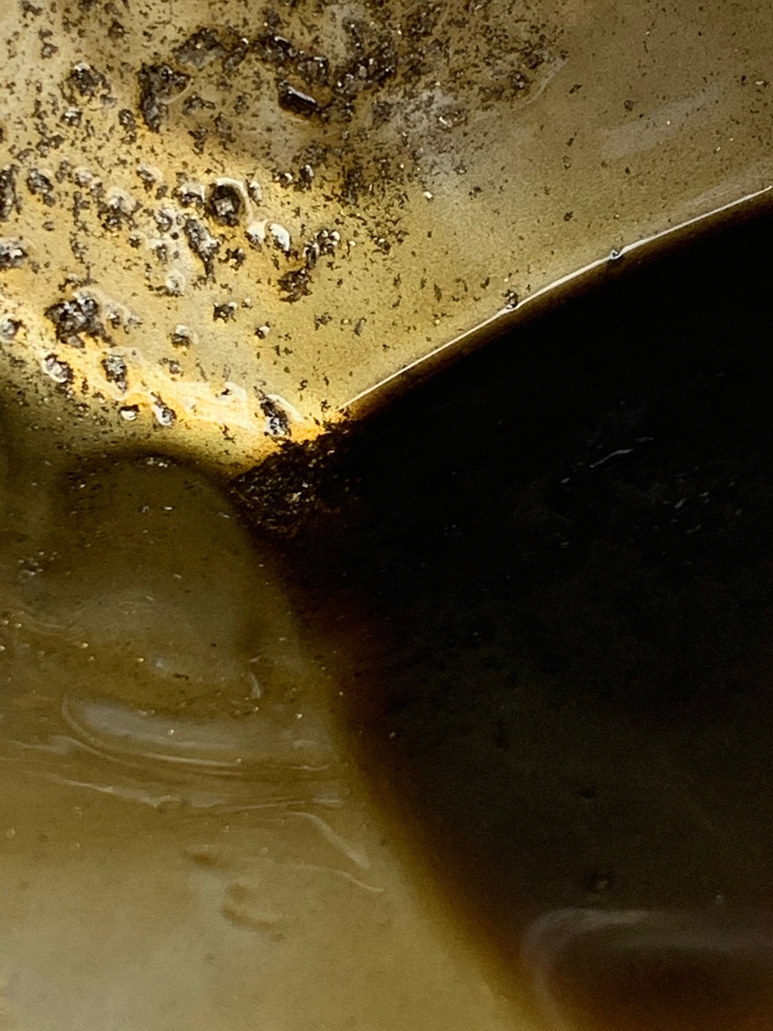

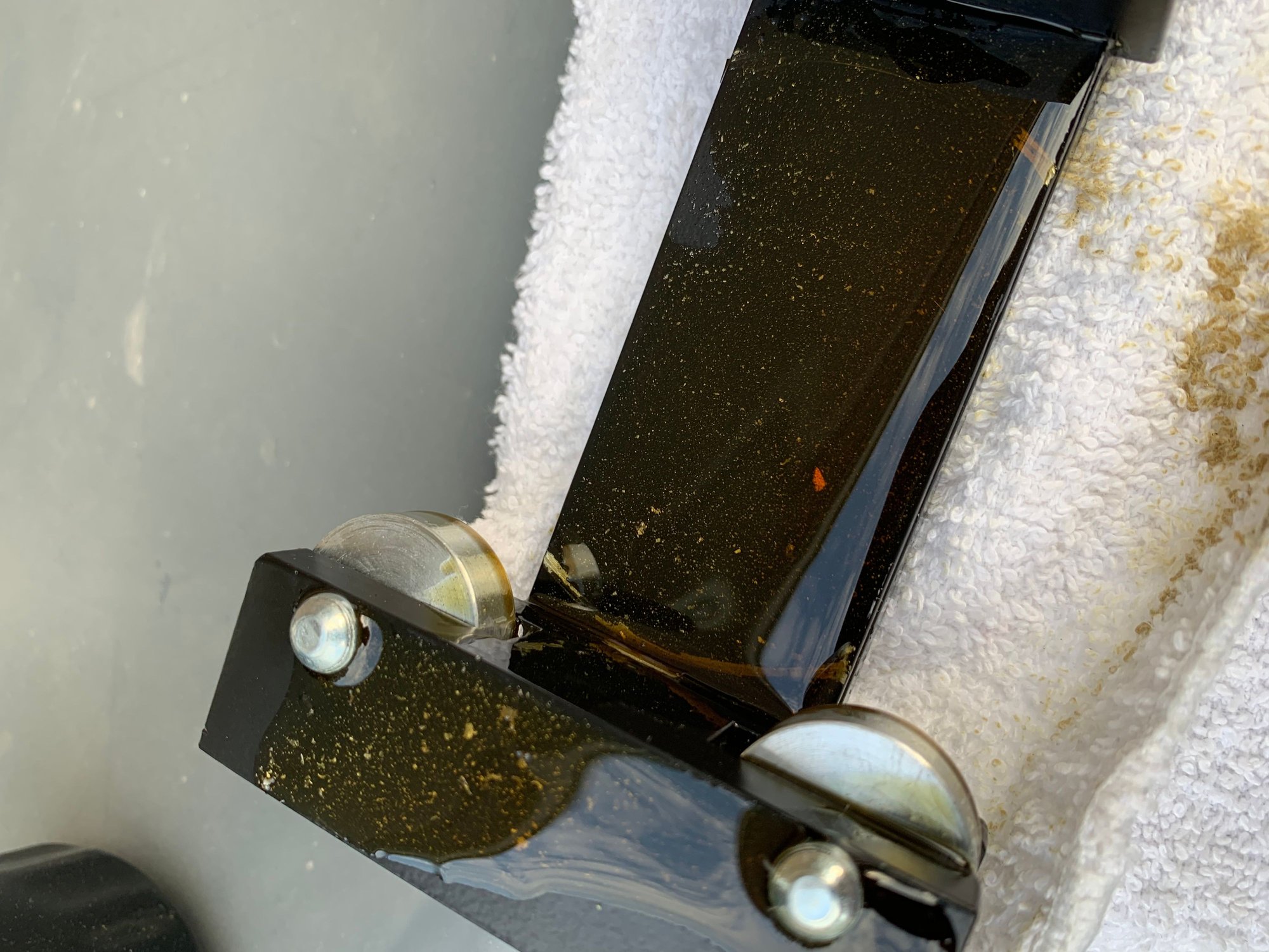

Lifter needle bearing and metal shavings

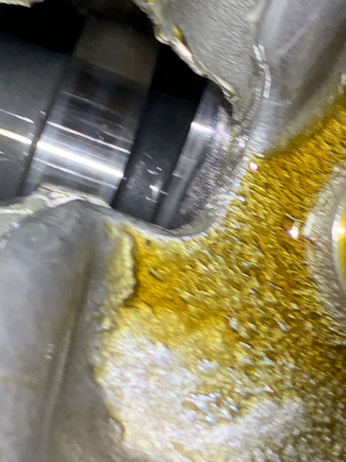

One of the cam lobes as seen from the valley
Metal shaving in residual oil as filter cam open
Bottom of filter cup, metal shavings
Bottom of element inside filter

Thats all the shavings and such that went through it and what the cam lobes look like

Gotcha. For what it's worth there have been tons of wiped out cams like that on modded and stock applications where guys threw in a new cam and lifters and went on with life.
It is likely to survive. Even looking that bad.
You'll probably continue to find bits and pieces as time goes on on the drain plug.
I had 8 valve springs break off at the tips many years back. I them all over time after several oil changes. Car ran for several years after and was eventually totaled by a guy that was the second owner after me selling it.

So you think it would have survived that junk going through the oil and in the bearings??? Still if I am gonna do it all again I might as well just do the stroker, use my block and buy a rotating assembly???

All I can tell you without tearing it down and seeing it is this happens a lot and they're fine.
You'll have to tear it completely down to know for sure.

Well nobody can guarantee yours will be fine. But cam swaps are done daily around this country due to failed lifters with ate up cams and a cam swap and lifter swap is what is done, oil changed, and send it. Those shavings would have gone into the pan, some got caught by the pickup screen, the others by the oil filter. It isn't real likely the shavings were distributed into the bearings.
There's a lot of folks here who suffered an ate up cam that threw a new one in it and kept on going is all I can really tell ya. And in factory form there are lifter issues too where mechanic shops swap the cam and lifters and go on. So CHANCES ARE you'll be fine.
