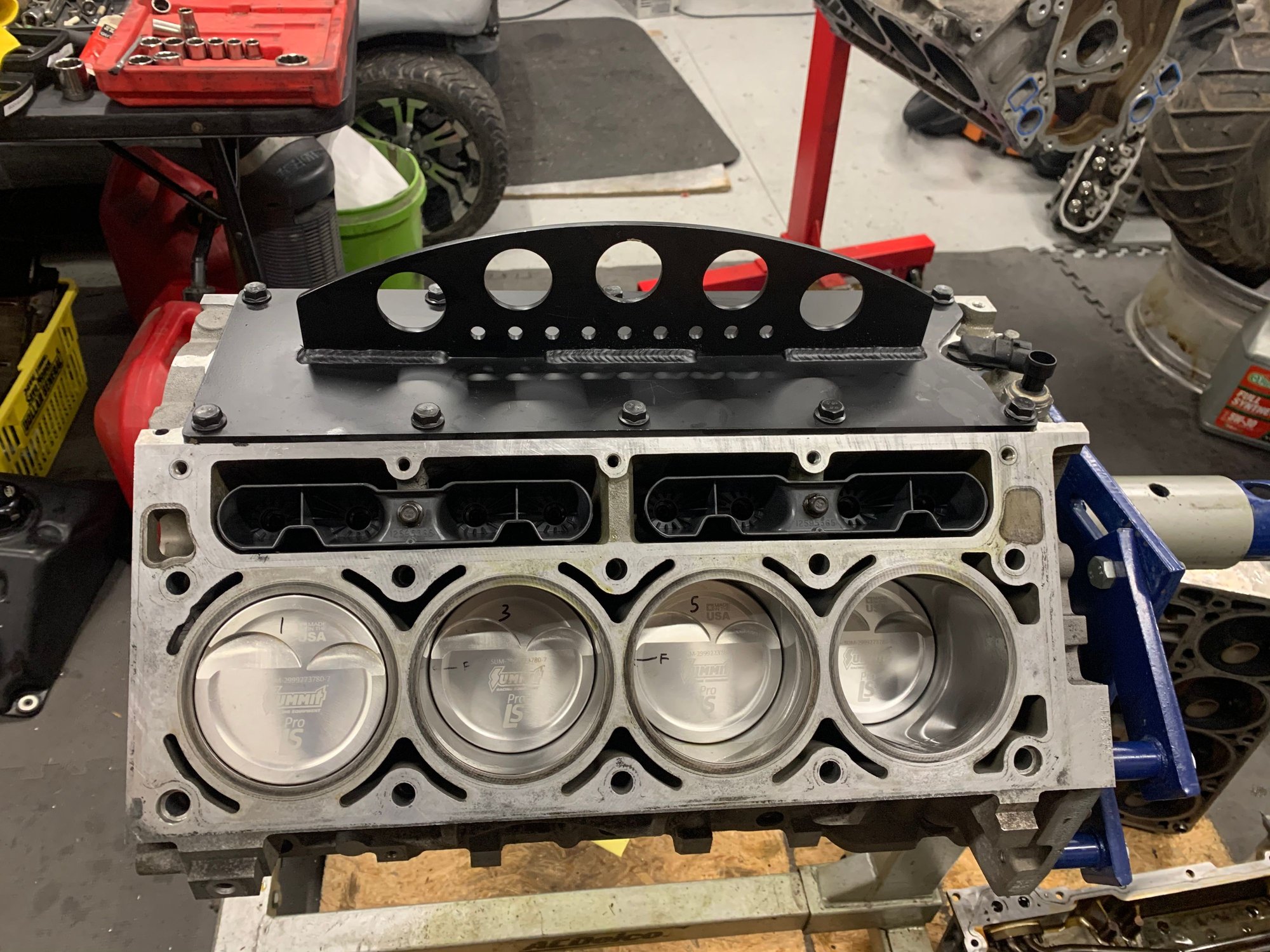

Here’s some pics.
sfi flexplate, arp flexplate bolts, jp billet timing set, arp crank bolt, gm lifter guides, ferrea valves (not sure I’m gonna use) and polyurethane motor mounts and trans mount insert.

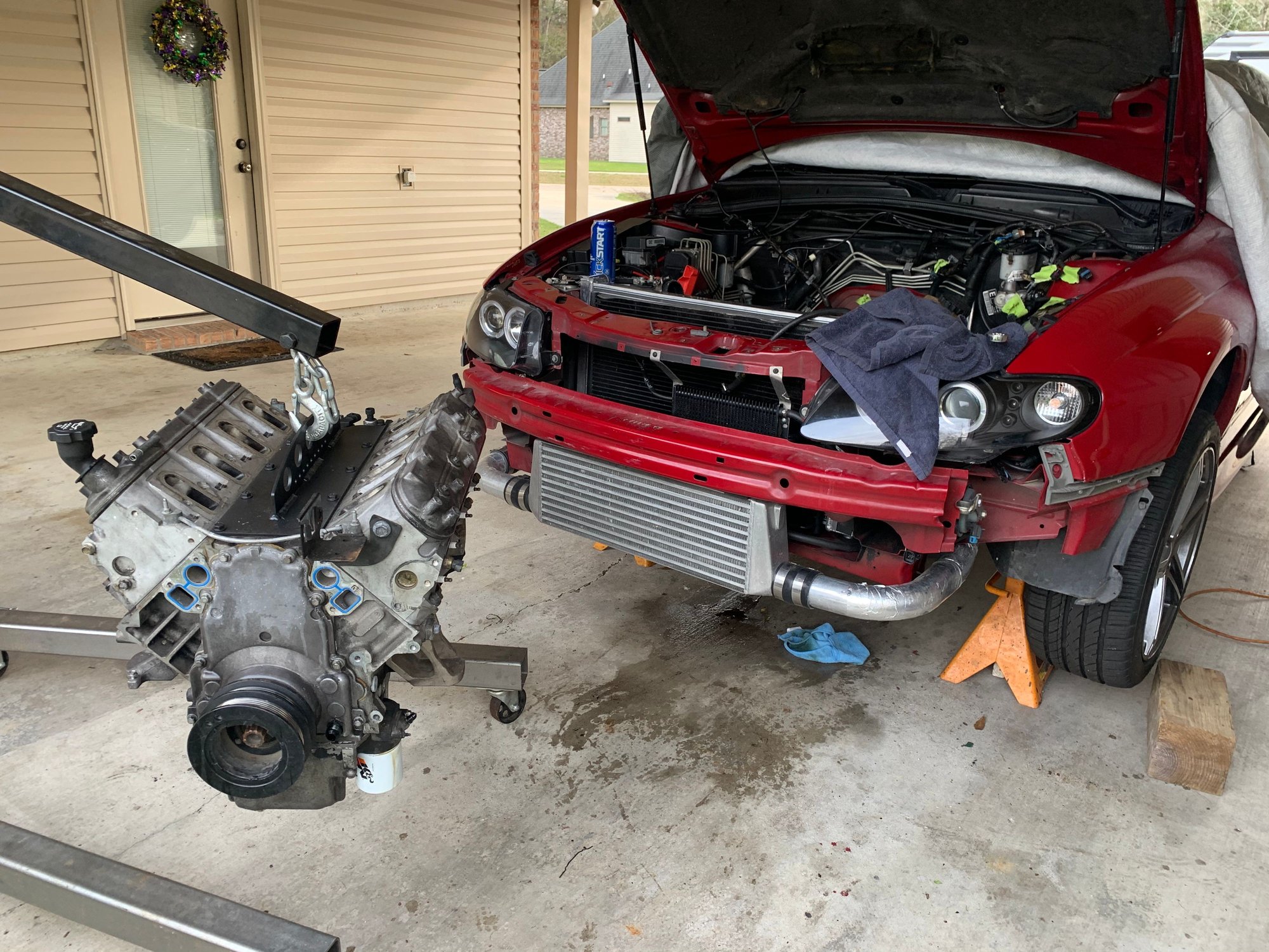

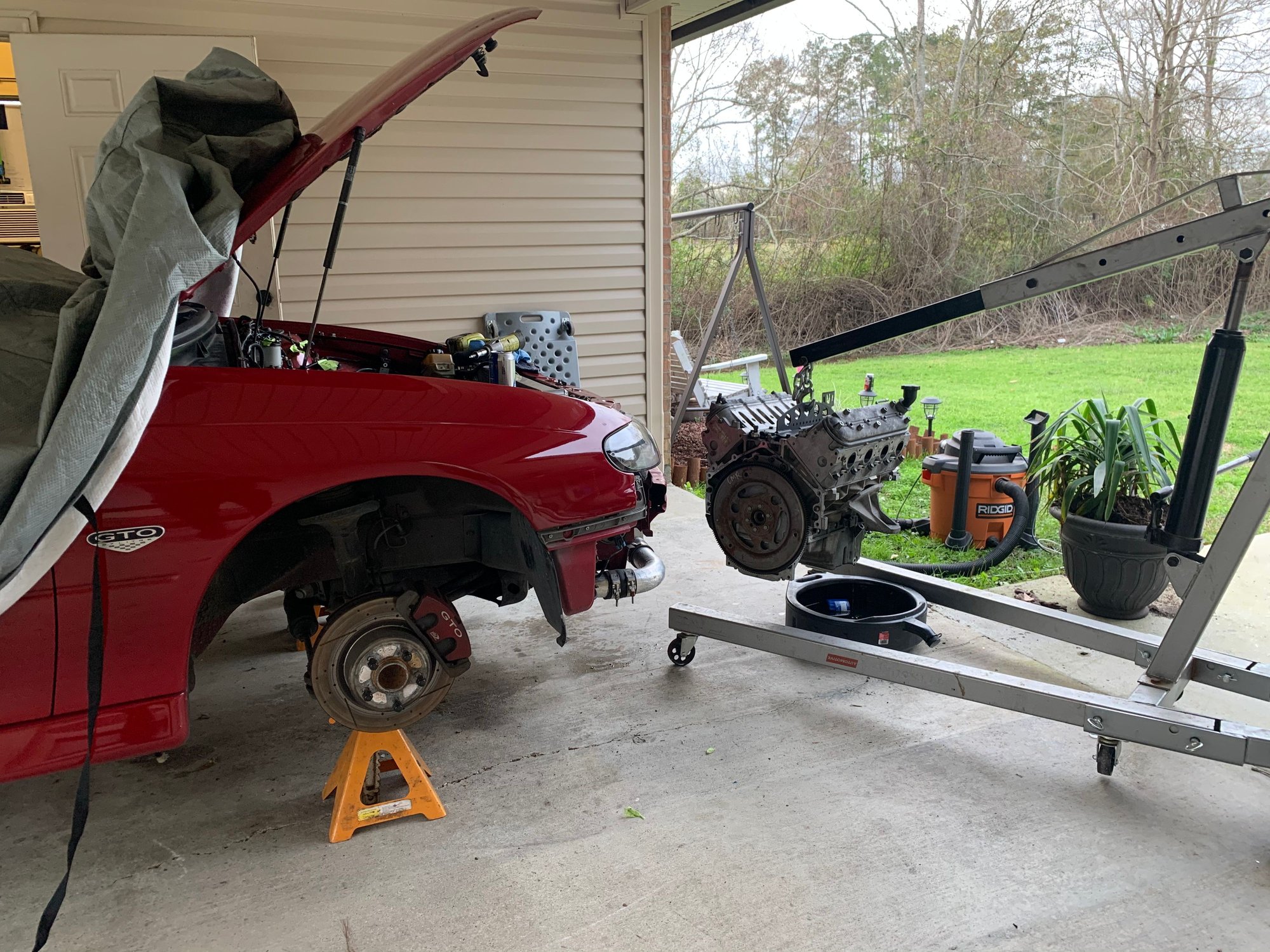

Got the motor out just now. Forgot to drain oil. Doing that now. No metal on the drain plug and oil looks good. Report soon

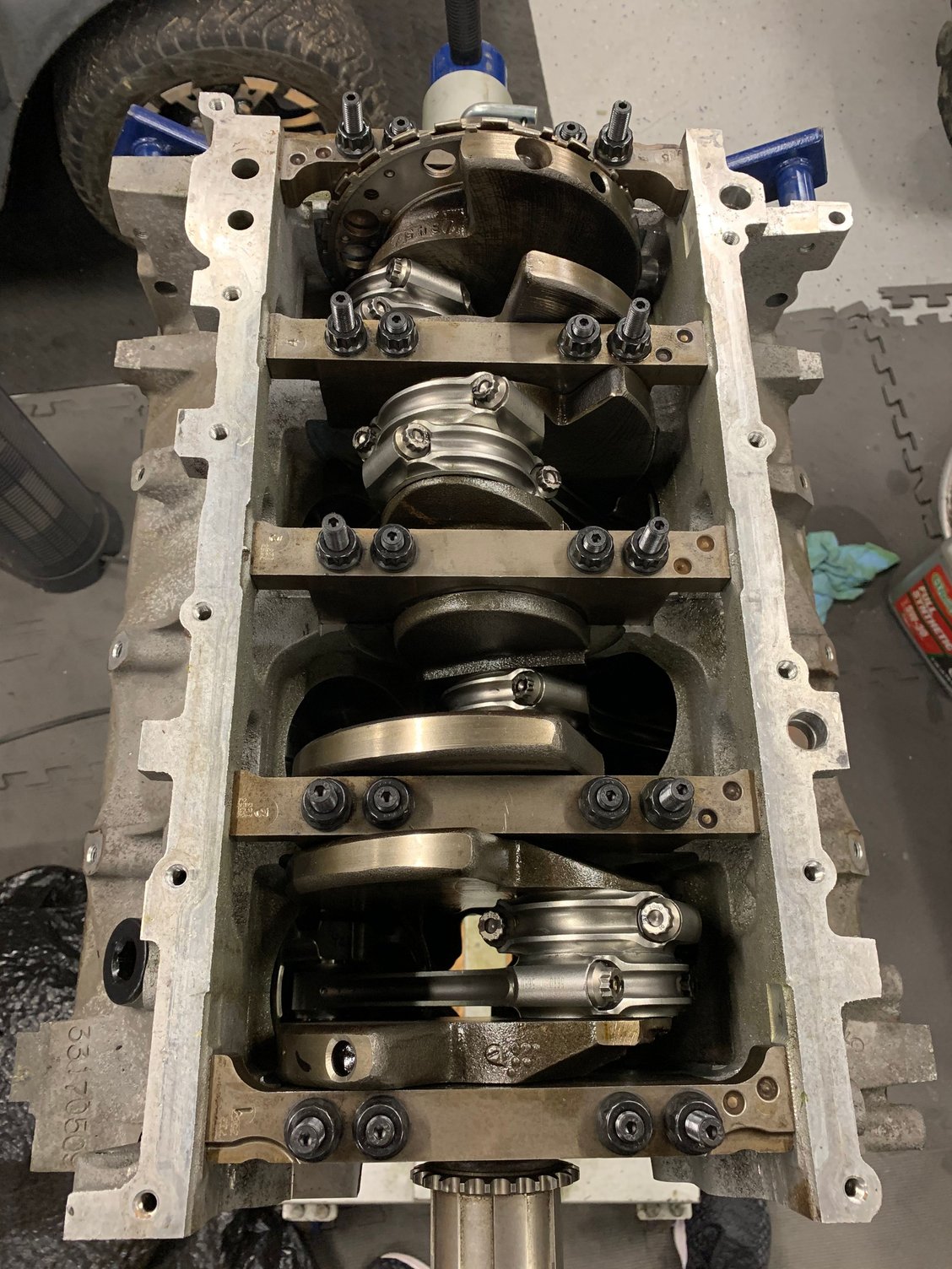

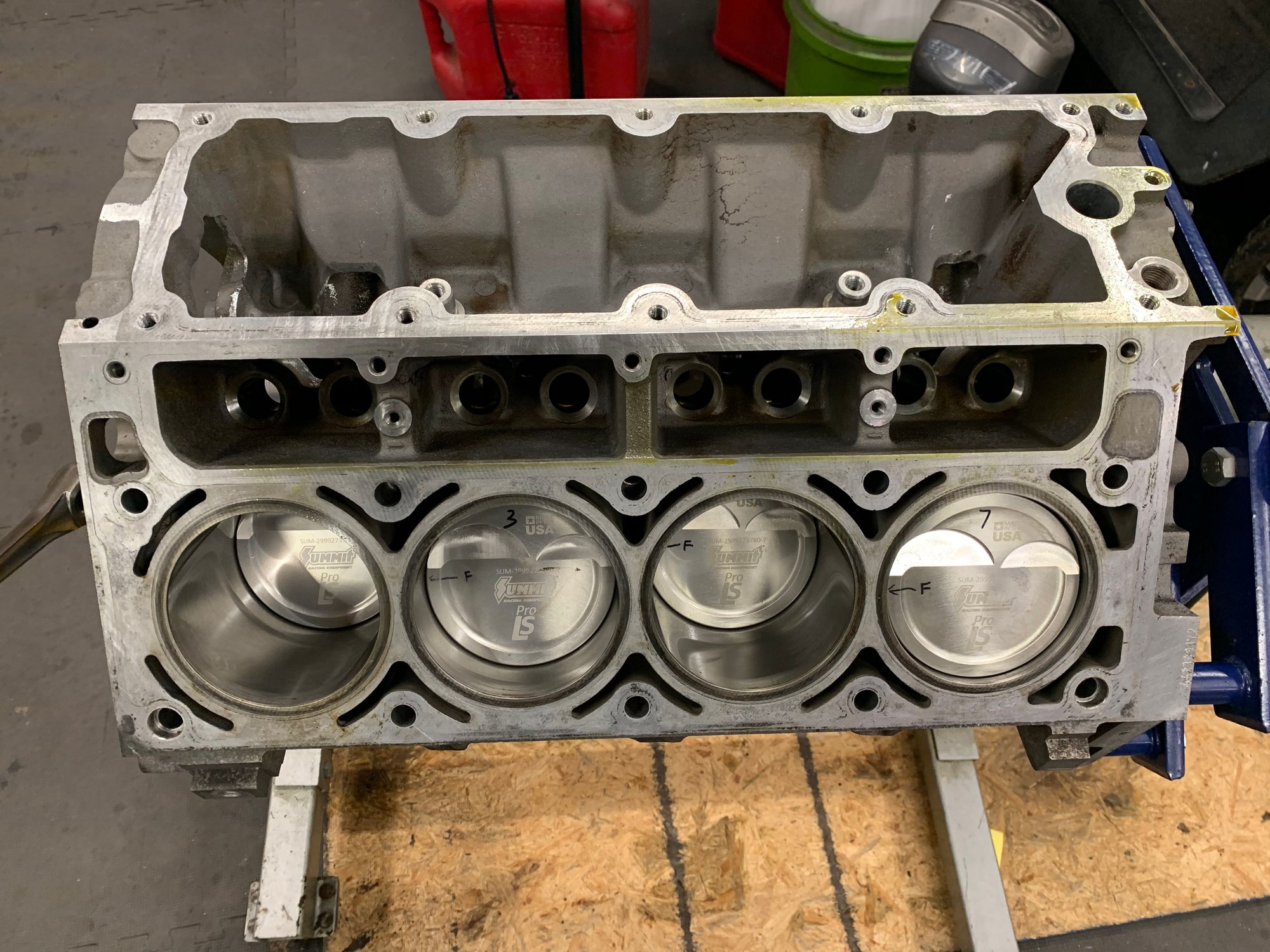

Progress....

Alright fellas. I have figured out the problem with my LS1. It’s exactly what I thought and where I thought. Busted ring land in cyl7. Luckily no damage to motor. And other good news. It’s a gen4 bottom end. I think I’m gonna put forged pistons in and an bag it for a spare.

Ported the oil pump. Shimmed it .080 because why not. Installed cam and lifters and oil pump. Jp billet timing chain set and called it a night. I did swap over all my sensors too.

NA LS1’s will bust ring lands. #7 is common.
They will also bust the ring lands between the top and 2nd rings. I have a 20k mile block that had that issue. It was procharged for awhile.
Gen IV Rods. You will have to let us know if it was full floating. Prob not?

I'll pull the one rod and piston out tonight and see. i'd like to find another piston and just fix it. Unless i can find a set of drop in forged pistons. i'm not paying to balance another motor.
