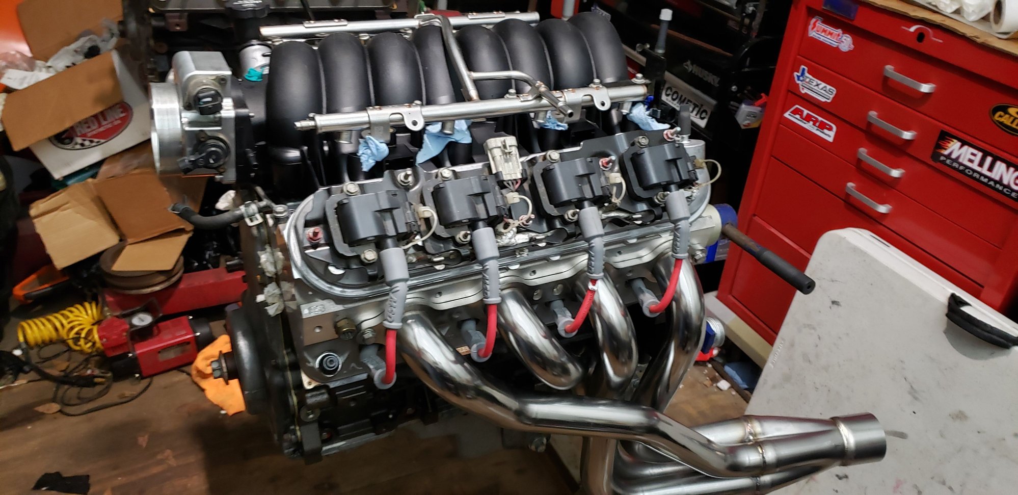

12.4:1 motor with 823's and an LS3 intake on this LQ9 build. I'm thinking about running this on C85.
stock bore???
Old Jan 30, 2020 | 08:33 PM
01CamaroSSTx's Avatar
Joined: Feb 2015
Posts: 5,979
Likes: 2,280
From: Conroe, Texas
Its bored .030
