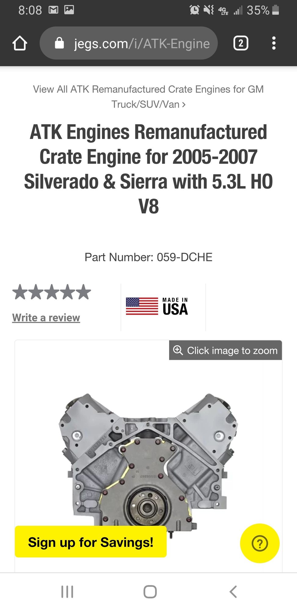

Tring to buy 5.3 L33 from jegs an crank casting numbers dont match to what I am finding on web. Can anyone help.
just want to buy right motor.

call and ask, what makes a L33 is...... aluminum block 5.3, flat top pistons, gen 4 rods, and 243/799 heads crank means nothing unless someone put a 58x reluctor ring on it
