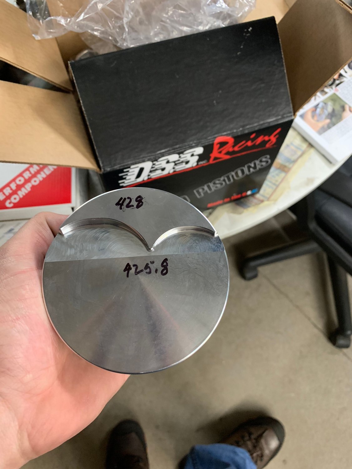

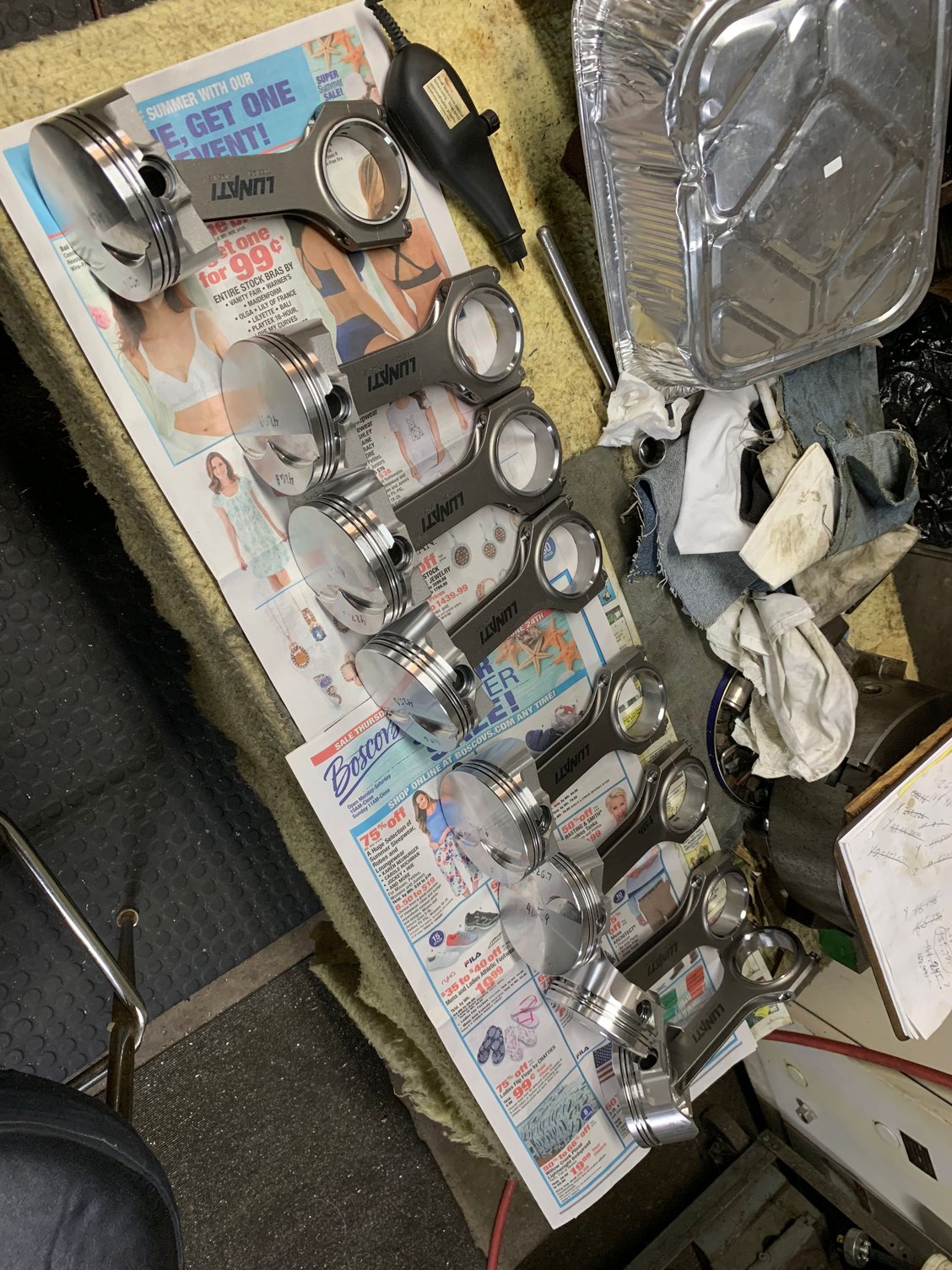

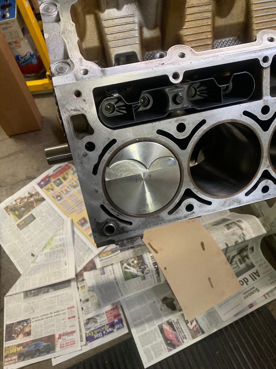

I
had no problems with mine in my 383

3.898 with an 4 in stroke , it’s good on the street now since I’ve put an blower cam , getting ready to do an proCharger next month.
