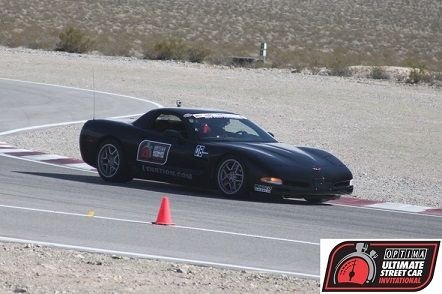

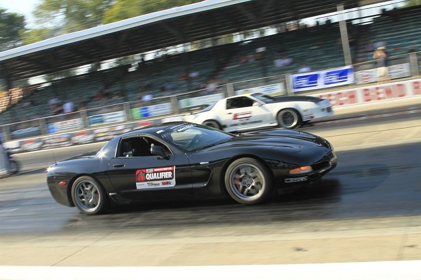

My personal hot rod is a 2002 C5 Z06. It started off stock and the LS6 eventually made 450/400 with Geoff's 226/234 cam and TEA ported heads. In that trim, the car set 9 ECTA Standing mile records (the top 4 displacement classes (C,B,A,AA) in two categories). It also helped me do well enough at the first Holley LS Fest to get into the Optima Ultimate Street Car Invitational and did pretty well there too. I took out piston number 7 (of course) doing some experimental V.E. tuning and cracked the sleeve a couple years ago. I've got an ERL Sleeved LSA block 427 going together with TFS 260 LS7 heads and the Saturn Stage 5 SUM-8721 cam. It should be back in the car pretty quickly and I'll get the car to some events this summer.

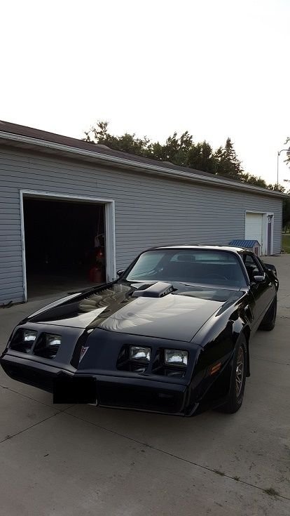

While I don’t currently own an LS-powered vehicle I have been around Chevy’s all my life. I have had a 04 GTO with the LS1 and an 03 Chevy 1500 with the 5.3. Both have been sold. The 03 1500 was replaced with a more appropriate tow rig, a Chevy 2500 with the Duramax. It tows my loaded down 26ft enclosed race trailer like a dream.
I have been a gear head from day one. I started tinkering with go-karts and ATV’s at a young age. I have a Motorsports degree from the University of Northwestern Ohio (UNOH). I used my time there to hone in on the areas I was interested in. My automotive passion is dirt circle track racing which I continue to do to this day going on 20 years. I have been running open-wheel modifieds going on 16 years. I have won rookie of the year honors, a track championship, and numerous races at various tracks. Most recently won a bigger paying $3,000 to win race in August of 2019. A weekly event pays $500 so that was a nice payday.
I’m a gear head through and through. For now, my time is spent focusing on dirt racing and my career at Summit with not much time for other projects. When the time comes to hang the helmet up I can see myself getting into some other ventures. I inherited a 79’ black T/A with the screaming Eagle from my late father who bought it new in 79’. By no means is it a racecar but it’s a nice cruiser. It could use some TLC and in due time it will get it. It will stay as original as possible, gold snowflake wheels and all. I can also see a 60’s-70’s C10 in my future. Power to come from one of my old race engines my dad and I put together or an LS. Time will tell.
Here's some pics of Joe's race car and his T/A.
Lastly, here's a couple pics of my baby.

The Pontiac looks great, wish we had the C5 over here in Australia, I like it more that my Commodore with the LS1.

Thank you. I had a '93 C4 before that and it was awful. The C5 is analog magic on a road course. It's not the fastest thing anymore, but very rewarding. Are you guys getting the C8?
