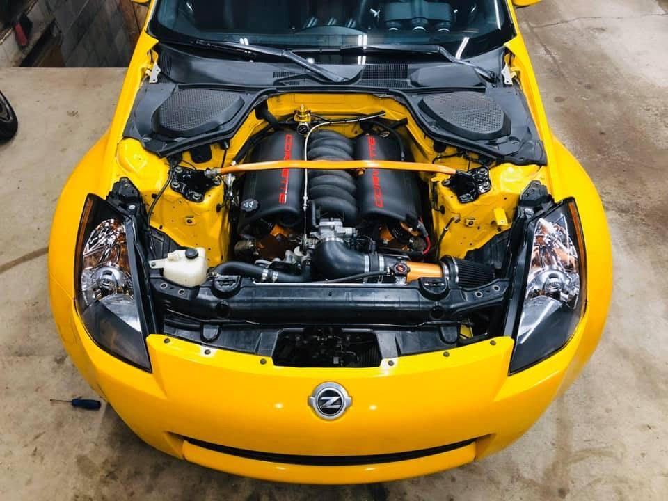

I recently completed an LS swap on my Nissan 350z using a bone stock LQ4, just refreshed with gaskets, and all new drive accessories, and an LS6 intake. I have a Tune date of May 4th
I want to swap a cam in but want an opinion. I am looking at the Texas Speed Torquer V4 (231/234 .629"/.615"). Ill be putting in the dual valve springs, and pushrods etc.... My local tuner recommended it but he also recommended the BTR LS3 Stage 1 cam (221/228 .609"/.571").
The car is an lq4 with 317 heads. no milling so 9.5:1 Compression. Im building a turbo motor on a stand so dont wanna get to crazy with this cost wise since that motor will be going in later.
Lq4 317 heads
Ls6 intake
Longtube 1.75" headers
T56 F body trans
3.357 LSD final drive
Car is used as an aggressive street driving, weekend car, and roadcourse car. My worry is the Torquer cam will lose a lot of low end due to lower compression
Thoughts??
