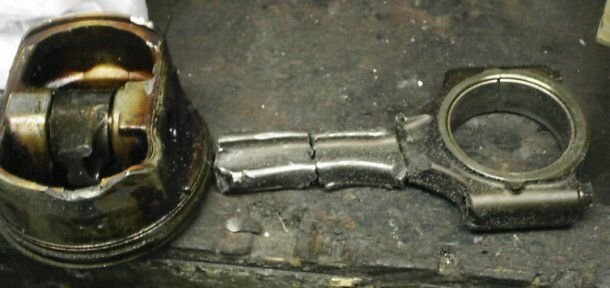

Has anybody ever done this? I’ve got a 2000 LS1 I’m rebuilding and I’ve got a set of gen 4 rods here. Will the rod bolts from the gen 4 work in the 3? I haven’t even looked to see if it’s even the same thread just curious. I plan to beat on the motor so I figured since I have them use them. Even if they will thread in and technically work will there be any chance of the rod going out of round? And I know the entire gen 4 rotating assembly is better I just don’t want to deal with driving the 3 hours to the only place that can balance it for the 3.908 pistons. Thanks

I’m more worried about the bolts stretching and letting a bearing turn. I broke a stock rod on start up once. Snapped in two pieces and beat holes in both sides of the block.
