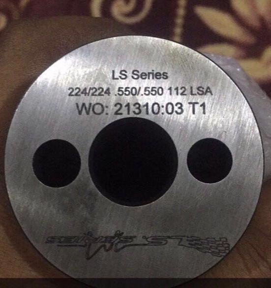

I have a question about this cam
Can someone help me get his information?
thanks

my engine 6.0 LQ4
heads 317
we need how many horse power gives
And If I want to install it, what I need to change it for?

I'd guess about 375 rwhp with stock heads
Lifters
Valve Spring
any thing else
thanks

If lifters are still good, keep what you have
You should use the LS2/3/6 beehive valve springs
