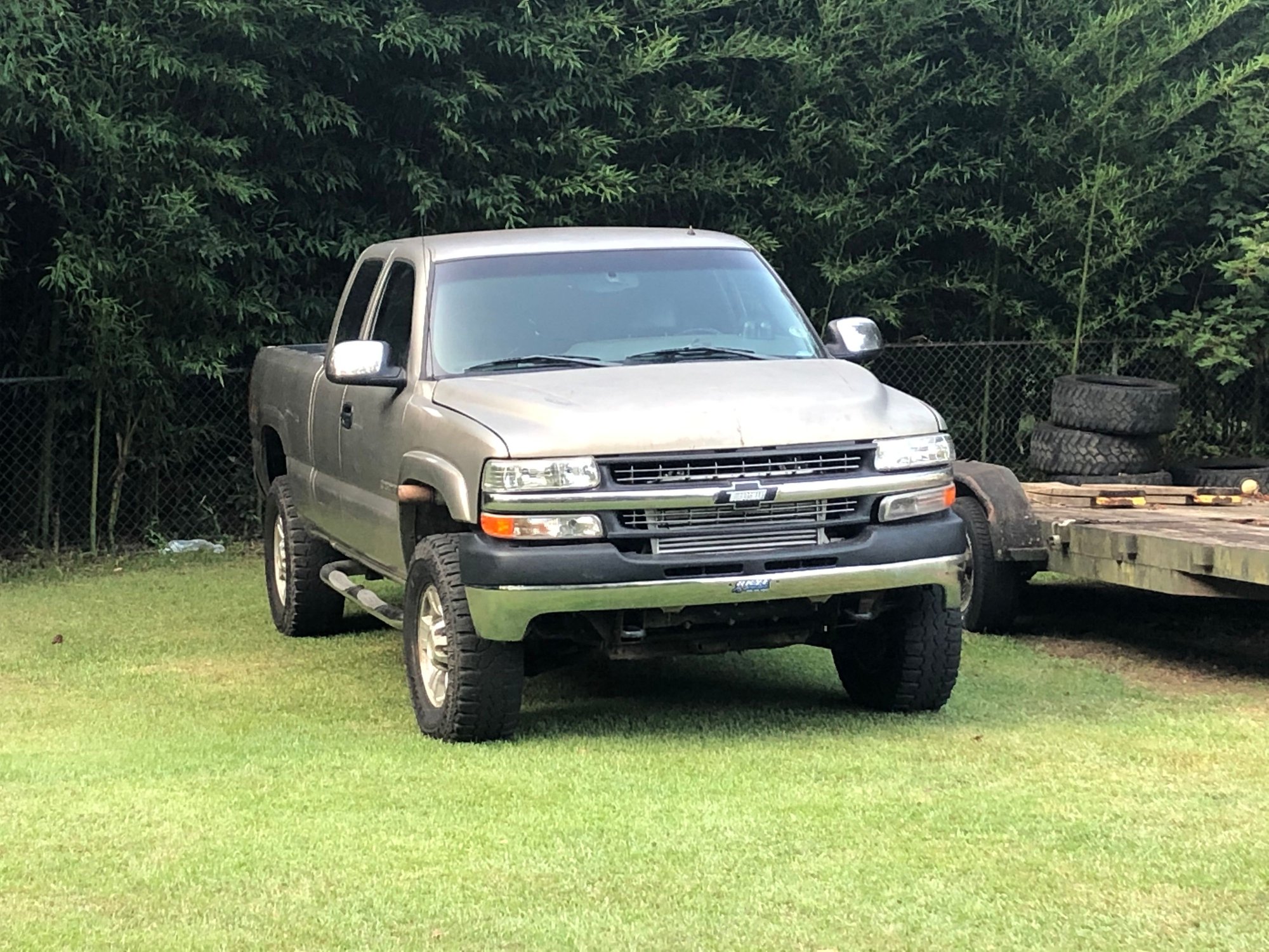

Damn that was quick. Thanks for the update.
We need pics or videos of this thing. (you had me at fender exit)
Old Sep 14, 2020 | 04:06 PM
  #33
TowRigZ's Avatar
Joined: Jun 2020
Posts: 33
Likes: 17
From: North alabama
Nothing special.
