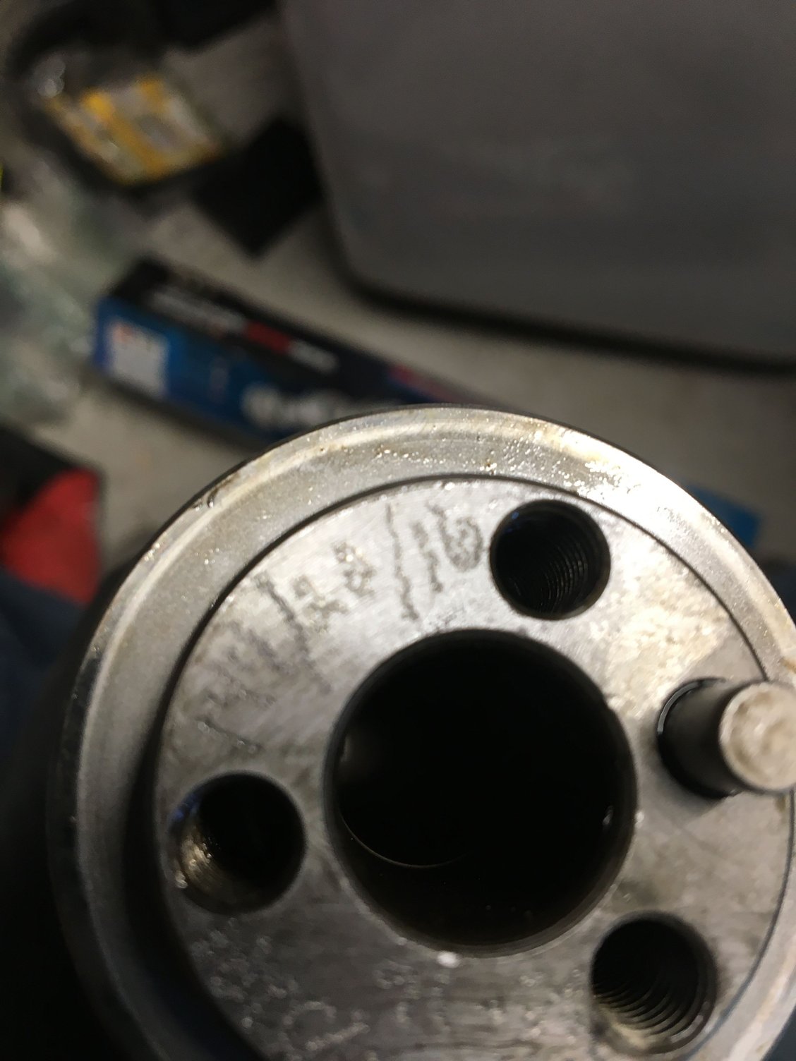

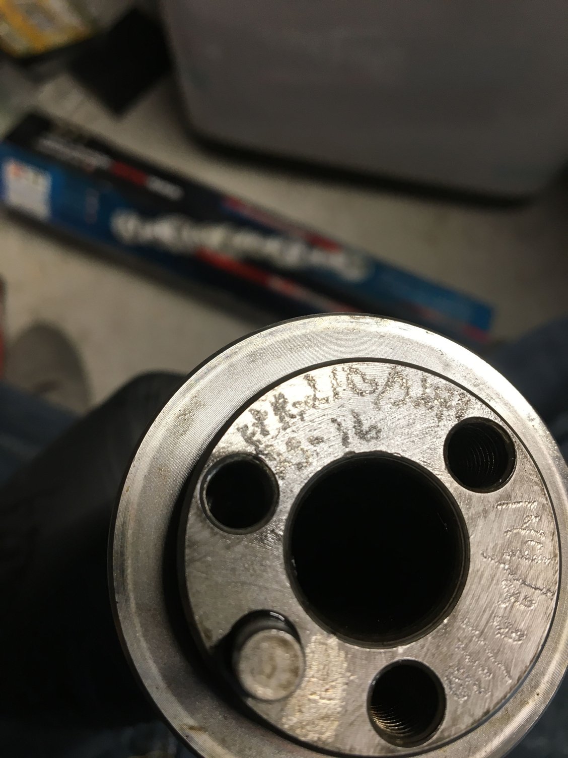

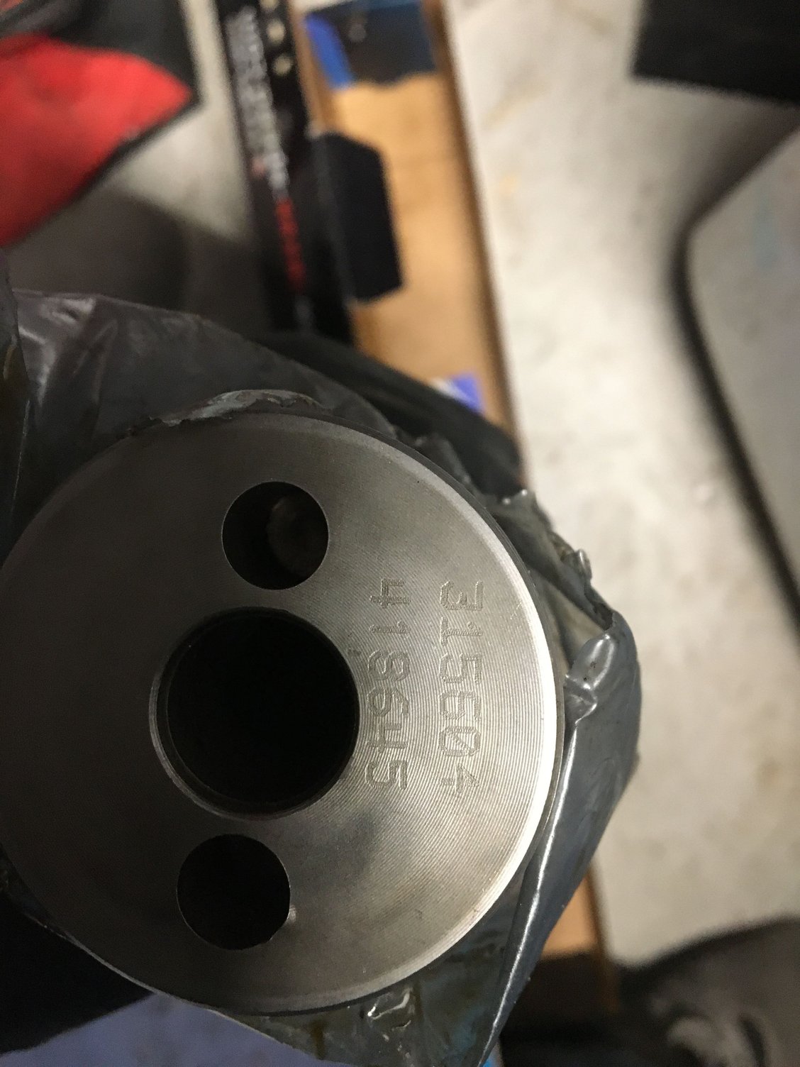

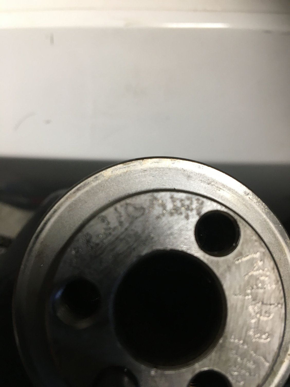

Pulled this cam from my lq4. Anybody know who makes this cam/specs? One side is hand etched and other is laser etched. Hand etched side is unreadable but tried to take best pics. Turboing an lq4 for a K5 and cant just run this unknown cam. Head was also packing double springs of unknown brand so I figured this wasnt a baby cam but who knows.

One last pic of last digits of number sequence

The cam core is a 234/234 .544/.544 114+4, but the numbers on the front suggest a regrind.
