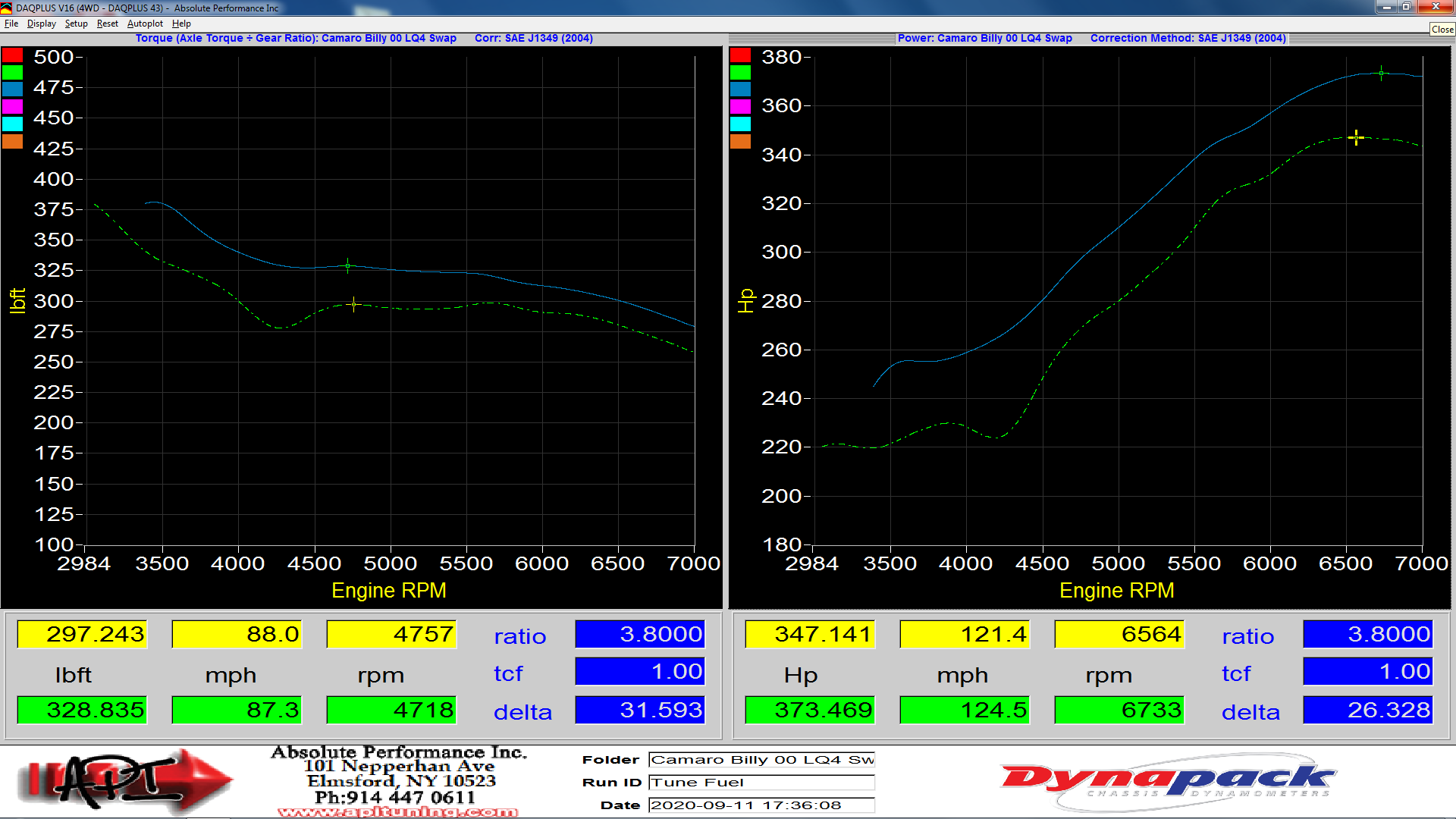

2000 camaro started as a 6 cyl. 5SPD. rebuilt a 2000 lq4 with btr stage 2 turbo cam. 1.685 long tube headers, deep motor sheet metal intake, 102mm throttle body, 42lb. Injectors, built th400, 3.42 gears. Made 373hp. On the dyno Friday. what do you guys think. #'s seemed kinda low to me even with the low compression and stock heads. Built for turbo but have to wait till next year

Looks about right through an unlocked torque converter.
What stall are you running?

Well they only make 300 to the tires stock and you have a converter that's likely killing off a little bit so I'd say you're near 100 over stock... that being said that isn't bad.

It's got a cheap 3200 stall needs a better convertor that I know

Btr stg2 turbo cam also isnt the most suited cam for an N/A motor so dont be too shocked
