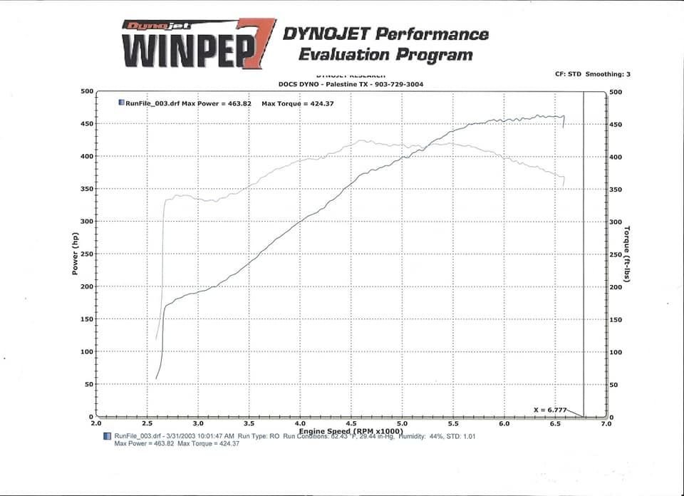

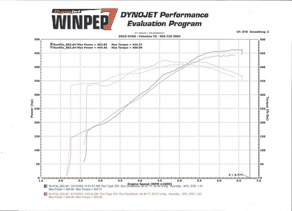

I just recently swapped out my Dorman LS2 for a Mamofied Fast 102. Gains were roughly 19whp. I know this is in STD and per the internet bragging rights I need to be in SAE, whatever; call it "445hp".

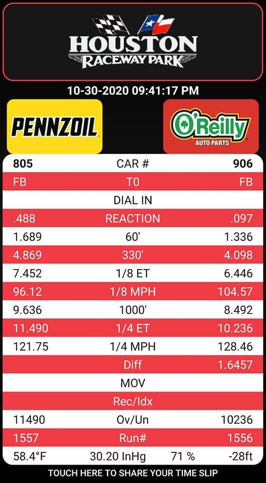

Track results:
Dorman ls2 (heavy clutch slip-no bog), 11.366@122.32
Last time at the track (Fast 102) wasn't good as I was working with a hydraulic clutch slipper and too little tire pressure; bog city. Driver errors, still learning.
Went 11.49@121.75, poor 1.689 and 11.496@121.95 - 1.691 60'. In hindsight I should have aired up the hoosiers and let it roll out. Car would dead hook at 4800-5900rpm and just bog.
Both good passes have a 3000rpm bog after the initial hit. With that data I don't think it'll hit that 10.xx I'm after (I'm anticipating 11.0-1 ish @ 123-5ish on a good clean run. Dyno graph below).

Car also has nitrous. Hit it one time on the dyno with a lean spike (BAP wasn't activating, that's been fixed). It did 560/513 ramping it in at 4600rpm. That's been fixed and I think it'll be a solid 560 on the 100 pill, can probably grow that up a bit more as I continue to lean on it.

Here is one of the 11.49 passes.
