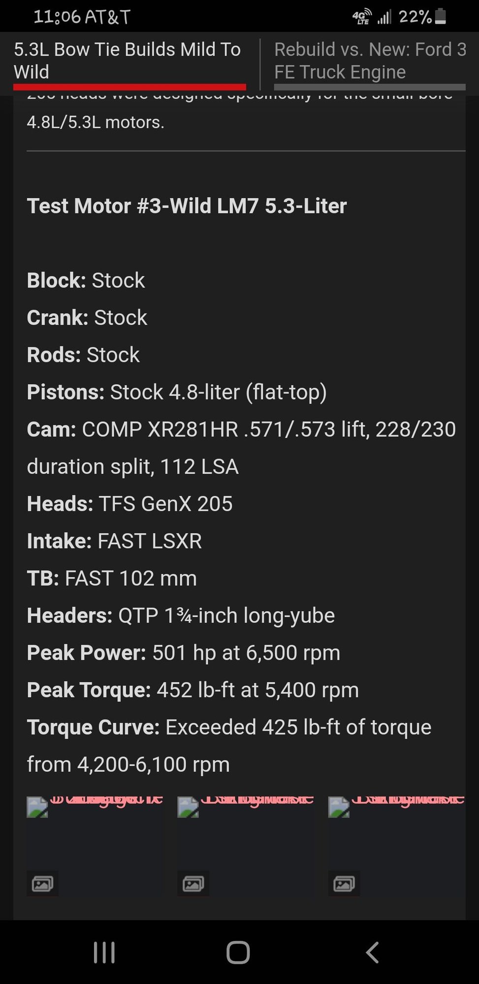

Now I'm not saying I'd try to get 500+HP out of 325ci but it certainly can be done.
Stock LC9 with gen 4 truck intake, 1 7/8" long tubes, and a Howards 222/225 cam/springs did 426 HP on my buddies engine dyno.
Was tuned on a little microsquirt too if I remember.
I'd recommend getting those 799 CNC ported, and make sure you're not running one of the bad carb intakes (there are some bad ones).
Then get a good cam/spring combo and some pushrods. 1 7/8" headers. You should be able to do ~475 at the crank pretty easily.
Trending Topics
As you can see it can be done. To get closer to the 550 mark attention to detail would be needed.... ~Squeeze the max compression for your best octane.
~ Lightweight valves such as LS3 hollows. ~ Port match the intake to the heads.
~ Maybe run a bigger cam depending on your stall etc.
~ Run at least 600 on the lift. ~ use a good quality lifter.
