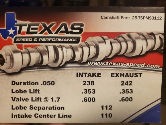

What r the cam specs? Not everyone remembers every speed shops cam of the day.
Old Jan 7, 2021 | 12:38 PM
LaBLKv6Z's Avatar
Joined: May 2010
Posts: 1,372
Likes: 215
From: Lafayette, Louisiana
238/242 .600"/.600" 112 or 113 LSA
Old Jan 7, 2021 | 04:09 PM
Vette-byrd's Avatar
Joined: Mar 2020
Posts: 188
From: NC
this 112 lsa.

Way to much duration for CI and the RPM limits of the stock intake .

One of my favorite cams. I ran a 111 LSA in my original LS1 and made good power.

No fly cutting required... But if this is going to be a street car, expect to be pretty disappointed. I won't sugar coat it for you, but I've tuned more than a couple customer's cars/trucks with this exact setup. The power won't kick in until way up top.
This is why properly matched cathedrals still own gen 4 LS heads at anything 408 ci and smaller. Way more mid range and low range. I personally think most others who chose the setup you have either just through parts together or based their research on Peak HP dyno numbers.

I think the MS3 is a fairly poor choice for a stock cube LQ4 with an LS3 top end. The intake duration is large for that set up and cube inch and the exhaust split of only 4 degrees isn't ideal for the typical LS3 head. I'd sell the MS3 and get a different cam based on the details provided.
