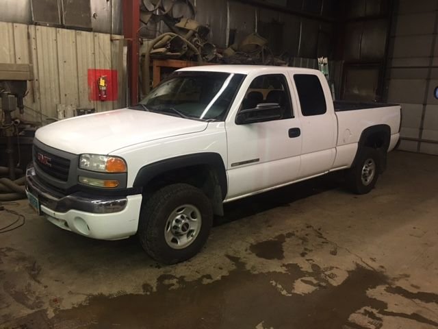

Yeah, check the RPO in your glove box. I'm interested also. 2 of mine were 3.73's, this white one was ordered with 4.10's...
