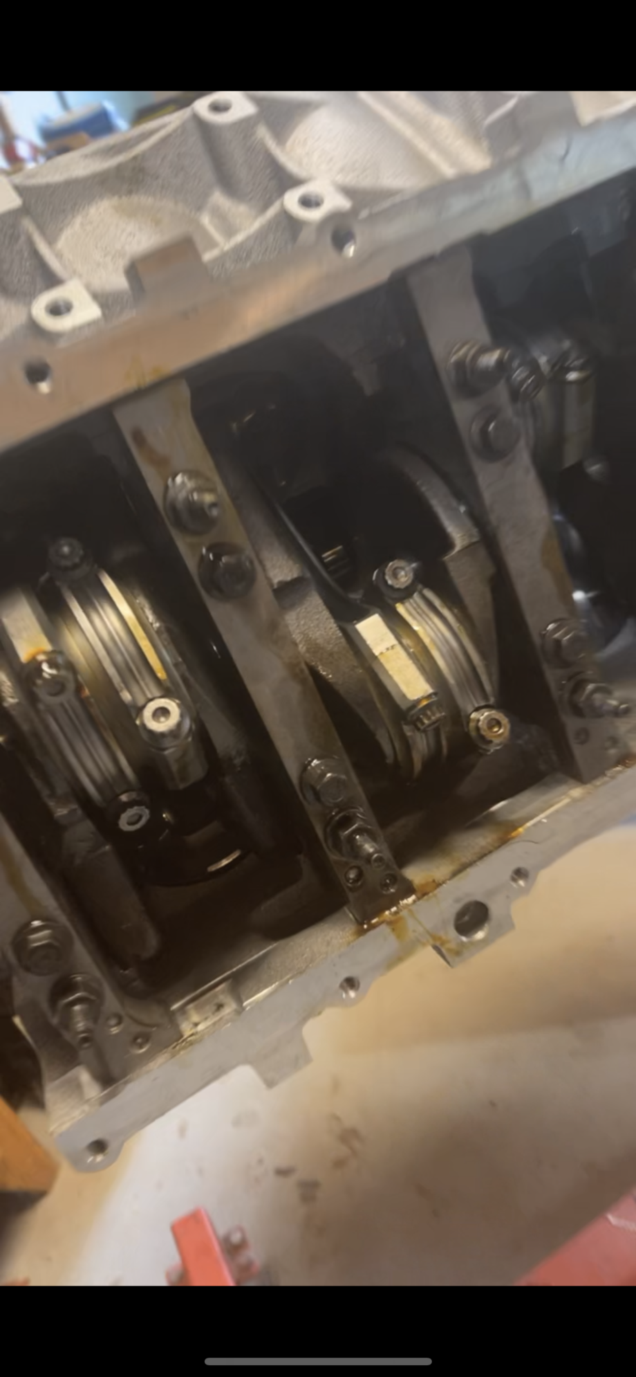

What bearings did you use? Do you know what the clearances are?
Can you show us a picture of how the main caps are installed?
sorry about the crappy pic, it’s a screenshot from a video I took. The clearances were all very close to .003 and the rings were gapped per wiseco spec, .026 and .028 if I remember right

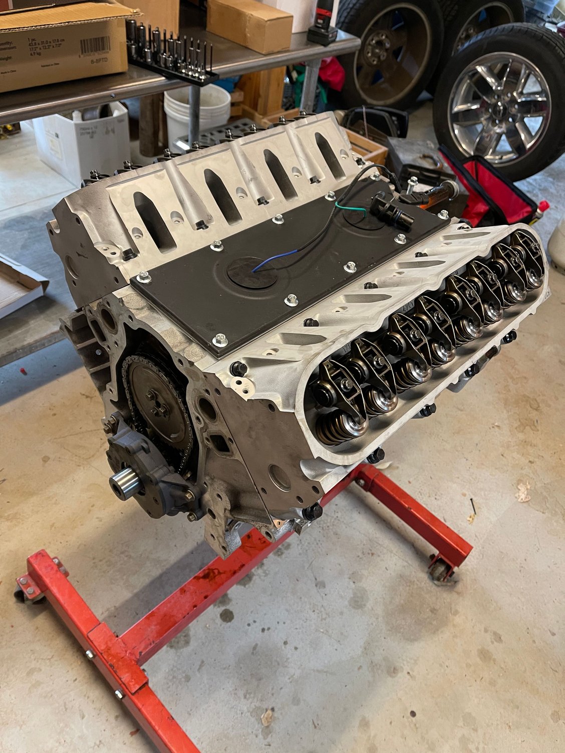

First picture show engine with heads installed - are you doing this with heads installed??
I am. Shouldn’t matter though I don’t think. No pushrods, no plugs etc. I put them on to measure for pushrod length.

From: Phoenix AZ
so valves are closed and you are Turing the engine to push all the air out the spark plug holes - Hmm good compression!!!
I think you do not have a problem!!!
that wasn’t a factor that I thought about... even with plugs out you’ve still got some decent compression. Another aspect is I’m using screaming eagle assembly lube from my Harley days. It’s gotta be the thickest assy lube ever. Stuff is like honey.

Is the rear cap, #5 cap facing the opposite way?
yes. Points on caps all point towards the rear of the motor, except for #5, which is the opposite. Is this correct?
Yes. It's a common mistake for people to miss that on a first time build which is why I asked.
