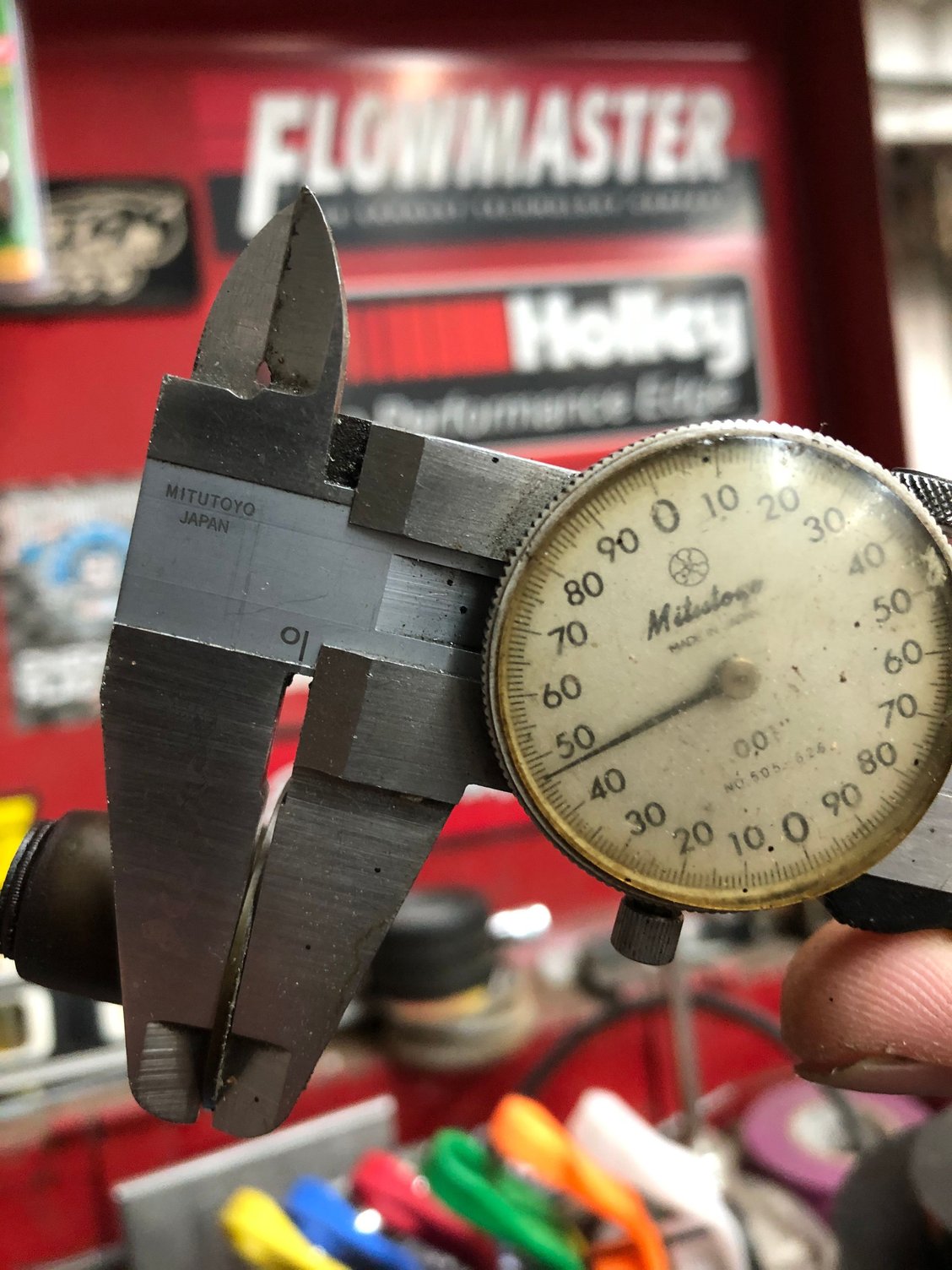

I always use the valve seals the hat style that have a shim built into them but I've never measure the thickness are these generally any thicker than the stock assembly?
Appears to be around .047. These are OEM from GM.
