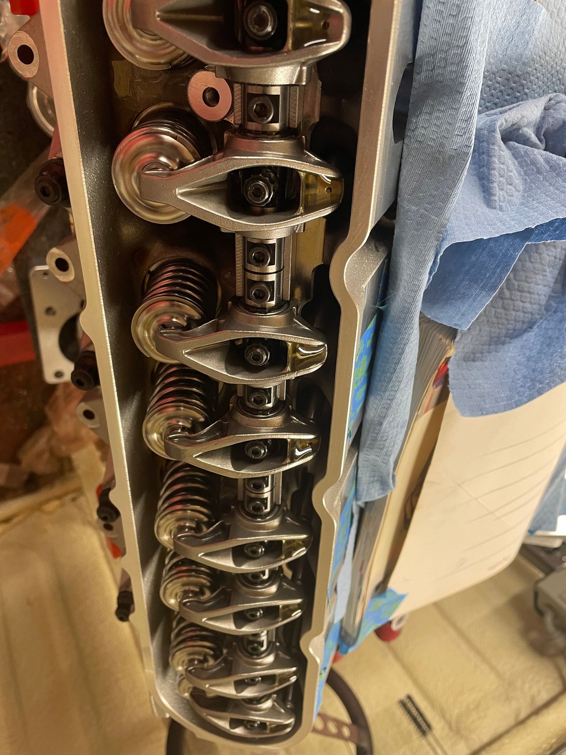

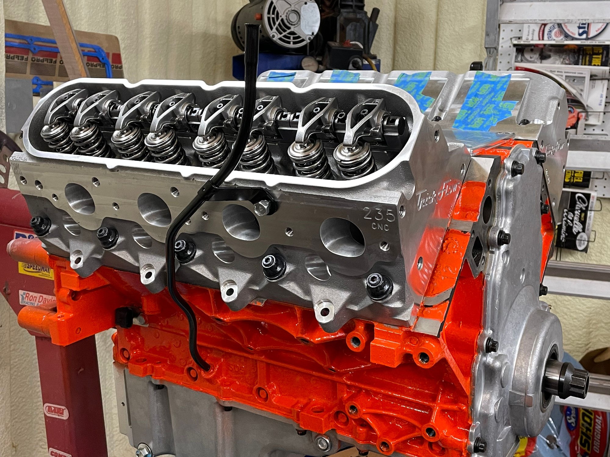

I’ve contacted him also, before building the engine and seen he’s done some great builds. Decided on wanting to stick with factory style rocker arms. And that BTR shaft mount rockers deal seemed like it could work good.
Here’s a couple pictures of it.
Verifying oil flow. BTR shaft mount rockers/BTR rockers
Before measuring for pushrods.
