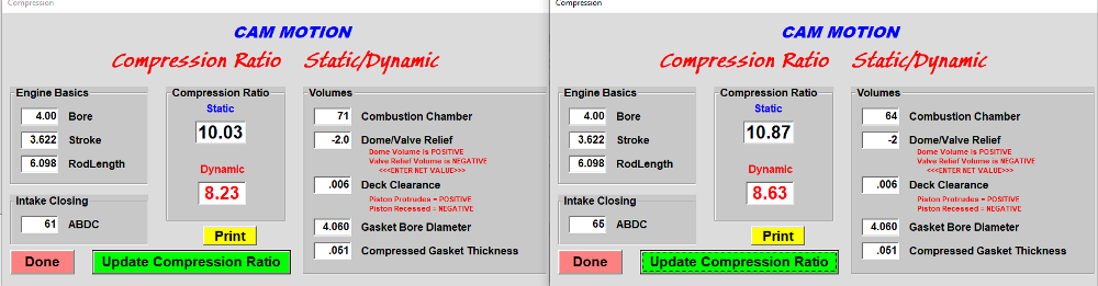

This would also be just like putting 243 heads on a stock LQ9 short block with the stock cam has anyone done that My question is, a stock LS2 or LQ9 with 243 heads is going to be almost 11 to 1, the LS2 cam has a much later IVC than the LQ9 cam so would this create too much dynamic compression to run a 1721 in a LS2 style longblock moving A 3500lb vehicle that gets lugged around below 3k all the time?

An LS2 is 10.88:1. As you said, 243 heads on an LQ9 is essentially an iron LS2.
Bearing in mind that DCR computations don't take VE into consideration, here they are for the two engines:
