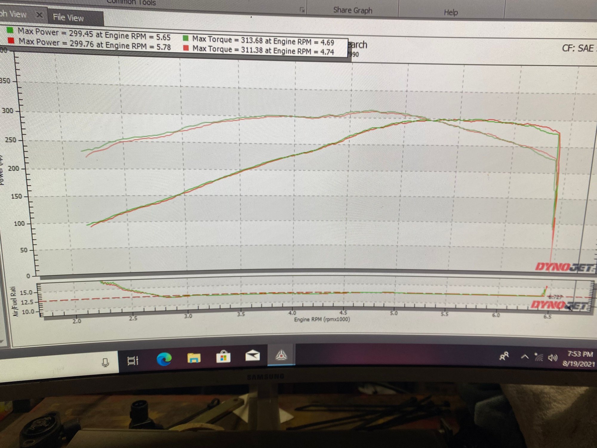

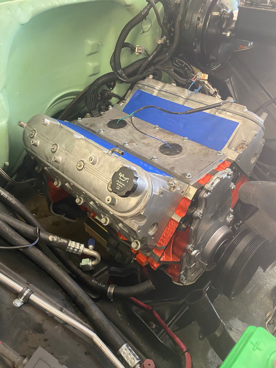

Just built my first 5.3L and I thought I’d share the results.
Engine:
-5.3L iron block
-243 heads (DIY bowl blending)
-CP forged pistons .030 over (10.5/1)
-Gen 2 rods w/ arp bolts
-Stock crank
-SS2 Cam 228/230 .585/.585 LSA 112
-Comp dual springs
-Truck intake/ stock TB
-Cast hooker manifolds
-1000 cc’s/ E85 tune
It made 300 rwhp/ 310 torque with 27 degrees timing at 210 engine temp (4l60e with 12 bolt). Very responsive, pulls from 2,500 to 6ish rpm. I’m super happy with it!!!

What size tires are you running and what Dyno was this on a dynojet or mustang ?

Nice!!
What torque converter?
Tire diameter?
Rear gear?
For what it's worth, that's almost 100% exactly what my bone stock LS1 did in my 2000 SS when it was stock down to a paper air filter. Stock wheels and tires. Stock everything. A 5.3 making LS1 powa is good.
